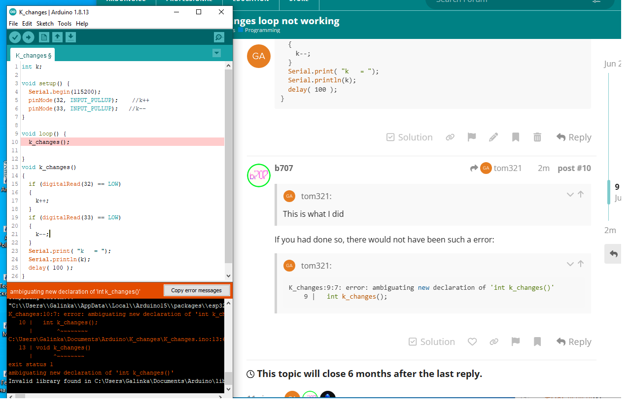

I did your suggestion, but I have an error
K_changes:9:7: error: ambiguating new declaration of 'int k_changes()'
    9 |   int k_changes();
C:\Users\Galinka\Documents\Arduino\K_changes\K_changes.ino:12:6: note: old declaration 'void k_changes()'
   12 | void k_changes()
exit status 1
...because you did it wrong.
Where did you seen an 'int' before function call in my post ? Do you know what the void and int means before function name?
I strictly recommend you read the textbook...

Thanks it is working
Me, I'm wondering just what the extension (if any) on that file is.
Anyhow, I've found it to compile just fine for me here, so that's the extent of my interest in the matter.
Characters next to the file name usually indicate "edits not saved"
Ah, thanks for that. I haven't used the IDE in years. That would certainly do it.
and since IDE usually automatically saves the sketch before compiling... then such a picture means that OP first compiled the wrong code (to show the errors?) , and then corrected it and made a screenshot.
And I'm at a loss, was this done by accident or on purpose?
Check his most recent thread:
https://forum.arduino.cc/t/void-loop-problem/1391775
Which is probably related.
