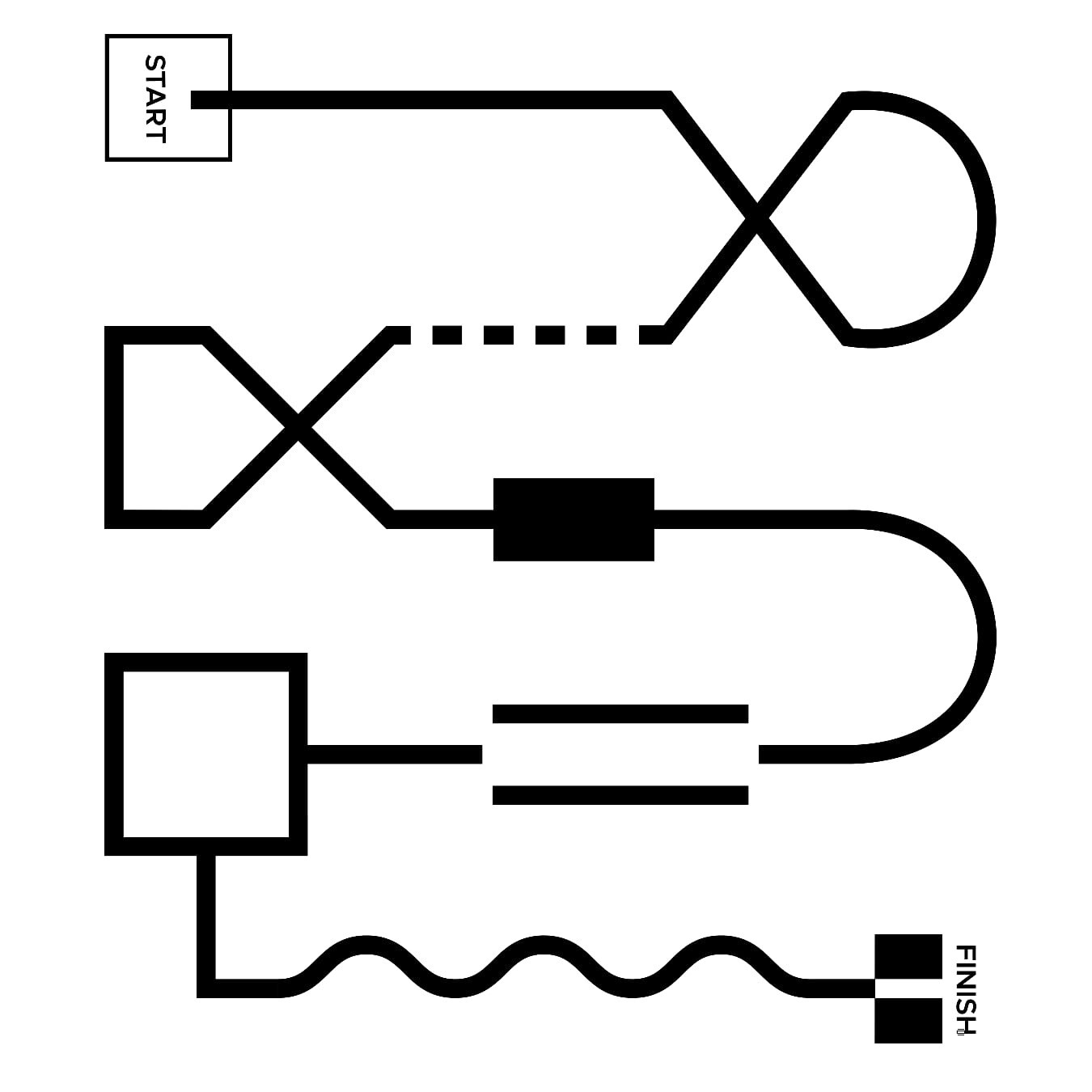

I'm working on a line follower for this map, that uses a TCRT5000 5 IR sensor array -
I'm not able to traverse the broad white strip and the black square after it, so I tried keeping track of the previous state of sensors and using it as a condition.
Eg-
If the robot went from a white strip to a case where the leftmost sensor detects black, it means the robot is on the broad strip but misaligned to the left. So, the robot turns to the right slightly to correct itself.
The problem is that this is not working, which I think is because the robot's momentum resulting in a previous State that is the same as current state, since the program loops quickly.

Any idea how I can navigate those parts of the map, by correcting this program or using a different approach?
Thanks
You may want to have a state variable saying if you can trust the current reading and if not a couple variables that hold the last trusted reading and time of this reading.
You update the last known good reading only if the current reading is good.
An idea to explore is to keep going as if there was no change for some time if the reading is not OK and hoping that it will not be too long until you get a good reading again
It will pose an issue for the big square so you need a bit more intelligence for that situation (you’ll traverse the square and see nothing until you hit a full signal on the 5 sensors again, so that might be your cue to turn and react to the readings))
