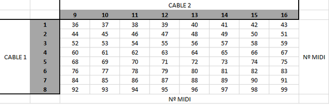

The first step I had to do was: disassemble, remove the solder from the flat cable that came out of the keys on my keyboard and went to his motherboard.
After that, it was necessary to map the keys, which I believed were mapped by my CASIO service manual. Sad mistake, the configuration of the keys were all wrong, so I had to take the multimeter on the diode scale and test each key to find out which combination of wires corresponded to the activated keys.
I used a spreadsheet to help me with the organization, I will provide the link.
PLAN MAPER

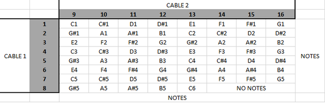

For those who do not know, it is the combination of wires that generates the contact of the keys and corresponds to the notes. In my case, I got a matrix as follows:
After finding each combination, it was necessary to find which note corresponded to each key, in order to finally find the MIDI number corresponding to each note. This part is very important for our program.
I used the table on this website , to find out which MIDI number corresponded to each key.
With this information in hand, I proceeded to the program code provided by our colleagues mentioned above.
The first thing I changed was the following lines, informing the number of columns and rows in my matrix.
const byte ROWS = 8; // 8 Linhas
const byte COLS = 8; // 8 Colunas
After that, I made the modification in the matrix itself, informing the MIDI numbers corresponding to each key mapped above.
