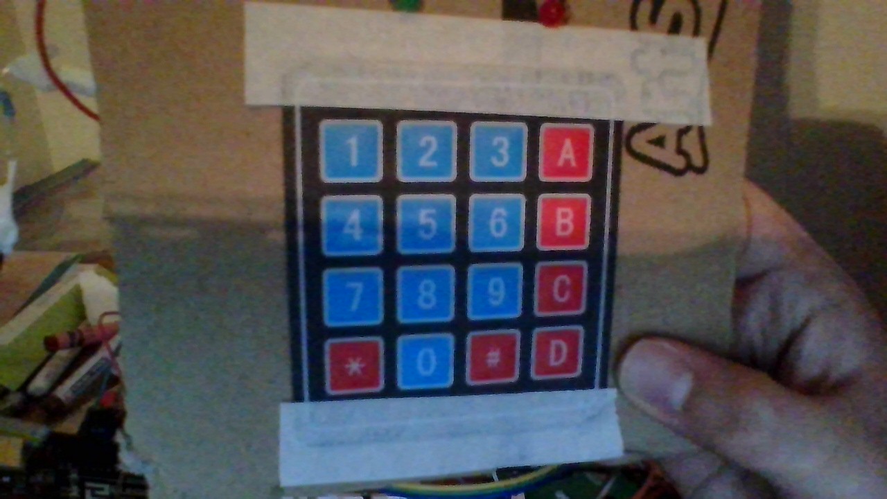

I am working on a safe that unlocks when a certain password is input. It was working fine until I decided to add an LCD screen. Now when I type into the keypad, the 1-6, 0, A, B, and D. I do not need the \* or # to appear. I have checked the wiring of the (in this case) 6-pin. This is the pin that (correct me if I'm wrong) controls the column 3rd from the top. I can provide pictures if needed. If you have any suggestions on my code that don't relate to the problem, they are greatly appreciated. Here is the code:

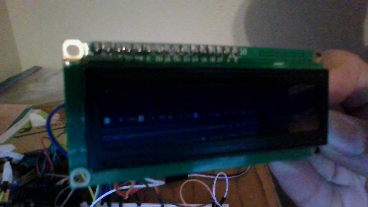

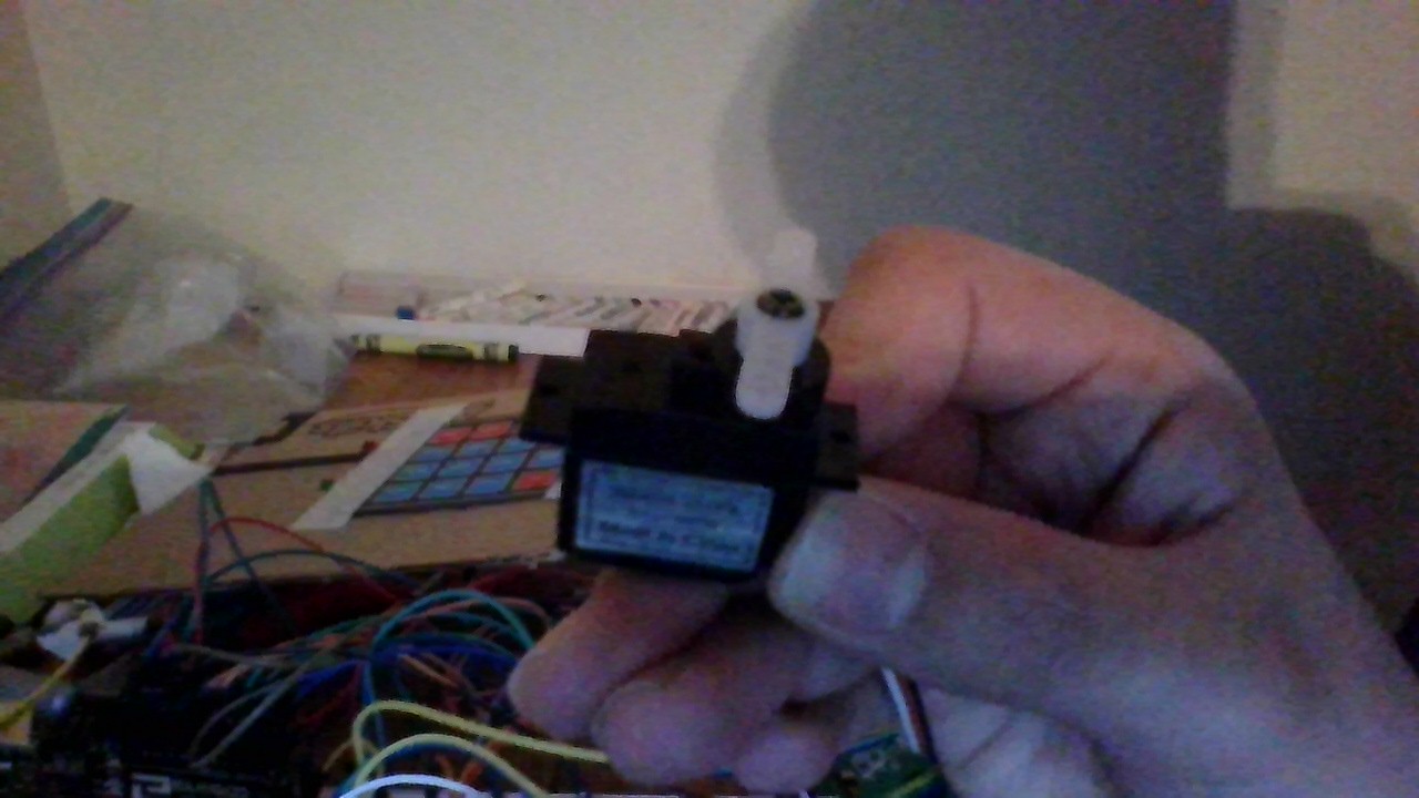

Do you have any suggestions without those? I am working on the schematic now. I used an LCD screen, a keypad, and a
servo, all provided by my teacher, so I have no links to provide. By the way thanks for helping me get help easier.
 ![IMG_20240411_194218](https://europe1.discourse-cdn.com/arduino/original/4X/2/5/8/25877afb64d4d430b97ed48ef17bcef66196dbba.jpeg)
 ![IMG_20240411_194209](https://europe1.discourse-cdn.com/arduino/original/4X/5/f/3/5f3e35c56c8717745bc2d7240b403ab8f74f8656.jpeg)
 ![IMG_20240411_194201](https://europe1.discourse-cdn.com/arduino/original/4X/f/2/a/f2aed679b22647742c110cd749759db8b72dbbb9.jpeg)

> [@2152191](#):
What happens if you use the sketch that did not have any LCD but did work?
Try that, and then try that as well as disconnecting the LCD.
Adding the LCD shouldn't break anything.
BTW you prolly mean the third row from the top?
> [@2152191](#):
What? Just say which keys work and which don't and which you aren't even testing, although you might fix up the LCD-less sketch, or make a version that just tests the keypad by printing the buttons as you press them, all 16.
a7

The LCD that is available for the schematic is different from mine, it will look like this ;
 ![image](https://europe1.discourse-cdn.com/arduino/original/4X/d/9/d/d9d8e7b7d8618831145abe6955d54a90dc1758ab.png)
Mine goes (left to right); VSS, VDD, V0, RS, RW, E, D0, D1, D2, D3, D4, D5, D6, D7, A, K
In the schematic, I will wire it to those, not the ones that are shown on the LCD in the schematic.
Thanks, alto, I meant that all buttons worked except in row 3 (7, 8, 9, and C)

> [@2152191](#):
> Here is the code:
OK I read your deleted post.
Try changing this temporarily
```arduino
byte rowPins[ROWS] = { 8, 7, 6, 9 };
to
```arduino
byte rowPins[ROWS] = { 8, 6, 7, 9 };
and see if the row that doesn't work is because it's on pin 6, or is a broken row.
That kind of thing.
Sounds like a broken wire or one that isn't doing its job.
a7

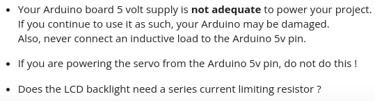

- Your Arduino board 5 volt supply is **not adequate** to power your project.
If you continue to use it as such, your Arduino may be damaged.
Also, never connect an inductive load to the Arduino 5v pin.
- If you are powering the servo from the Arduino 5v pin, do not do this !
- Does the LCD backlight need a series current limiting resistor ?

So, how would I best remedy this, Should I Wire the servo to the 3.3-volt supply? How do I wire the circuit to provide the necessary power without too much power?
All the components have been working fine except the keypad, is this normal, or do they just randomly cut off due to lack of power?
You mean the servo right?
What do you mean by the LCD needing a resistor? I have the potentiometer, that controls the LCD backlight, what else do I need to have? I have the (you can probably see this in the schematic) VSS connected to the ground in the breadboard, and VDD connected to the 5v in the breadboard, these don't have any resistors. It's the A and K to the far right that have the potentiometer. Do I need resistors for the VSS and VDD?

> [@2152191](#):
No. Power the servo from an adequate source of 5 volts, like a 10 watt cellphone charger, or a real power supply.
You could also use 4x AA batteries.
For now, disconnect the servo and let's get the keypad and LCD working.
a7
