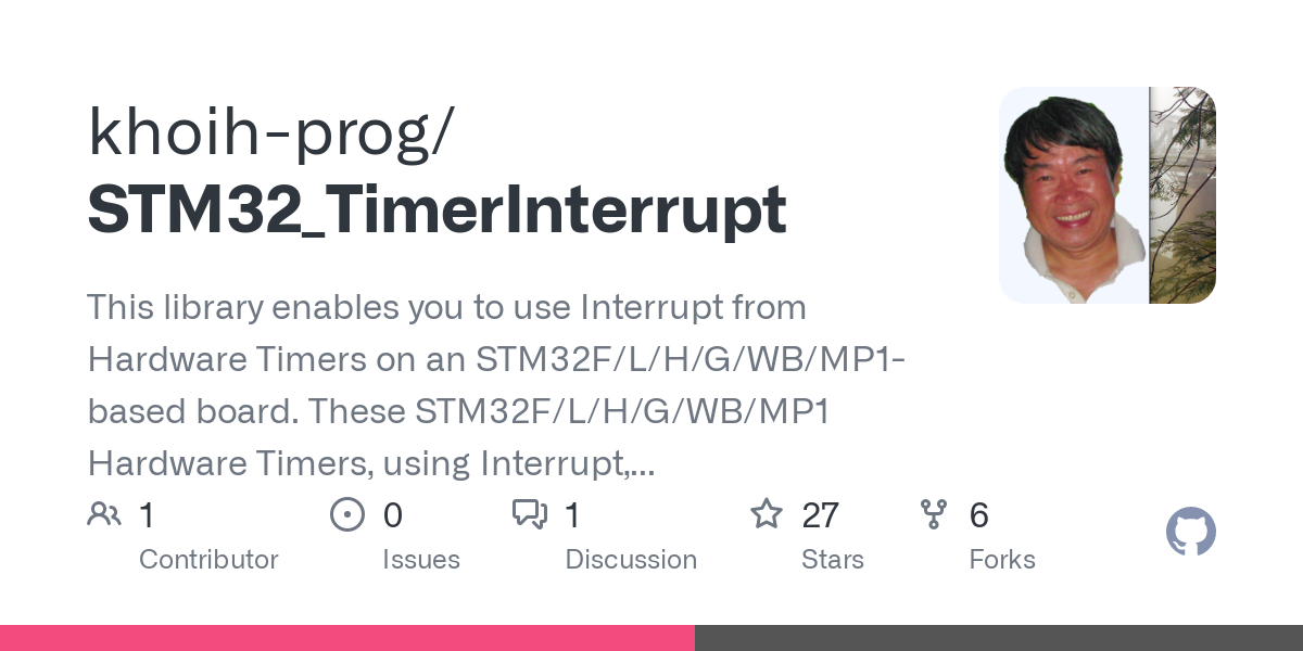

In order to make the relevant information available to readers of this thread, I'll share a link to the library code and "doc at the git" in question:
