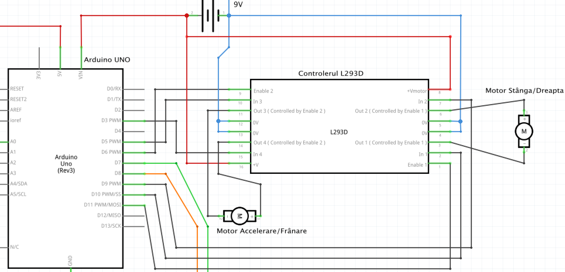

Hello, I have an RC car which has 2 motors (one to accelerate/brake, one for left/right). These motors are controlled by an L293D controller. I have tested many times and it was working fine but yesterday I made a final test (nothing changed in code or wiring) and I realized that the accelerate/brake motor rotates very slowly and the other one is just shaking.
I was thinking that maybe just my battery discharged so I tried with a brand new and I still have the same output. I measured the supply pins of the L293D and it gets 9V so I have no idea what happened.
My sketch is the following:

The schematic is attached.
Can you please help mi to find out what can cause the problem?
You cannot use a 9V block battery for that (besides running motor without load). Your (9V) power supply needs enough C rating which is typically the case for eg. LiPos.
Hermann.
You're using the same "reverse" for both motors? Try: boolean afReverse = true, lrReverse = true; A different "reverse" for each motor
