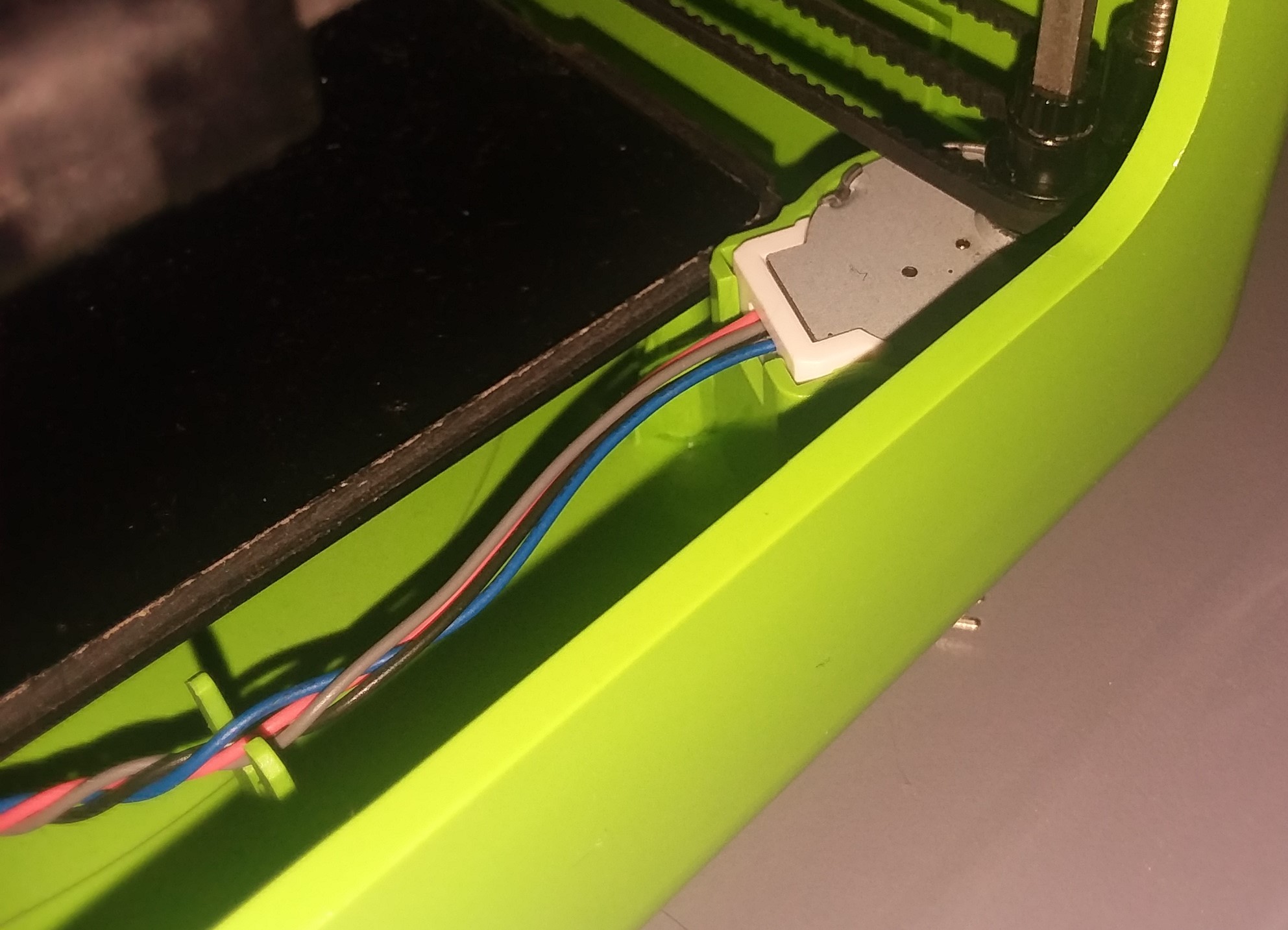

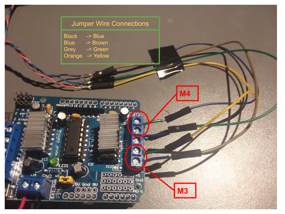

Here are images of my setup. The first image is of the 5v 24BYJ48-64 motor. The second image is of my wiring setup for the L293D v2 shield with stepper motors. Is there anything visibly wrong with this?
Note: the motor wire order from top to bottom is orange, grey, black, blue.
Wiring setup

It seems you're powering the Uno through it's V-in from that 5volt supply (the yellow jumper).
That is not enough for the Uno's 5volt regulator to make a stable 5volt for the Uno.
V-in should be at least 7volt.
But using a >=7volt supply on that screw terminal will increase your thermal problems.
Leo.

The 24BYJ-48-64 is a 5 wire unipolar motor, the L293 has 4 output terminals, what are you doing with the 5th motor wire?
The stepper motors on the M3D website (I am using stepper motors from a 3D printer) are listed as 24BYJ-48 motors (1:64 gears) I think they may be custom-built to be bipolar instead of unipolar.
M3D stepper motors
Here is a link to the closest 24BYJ-48 stepper motor I could find commercially available. When using these specifications the motors work perfectly (they don't even heat up, only the Ardafruit Motorshield V2 does)
Motor datasheet link
