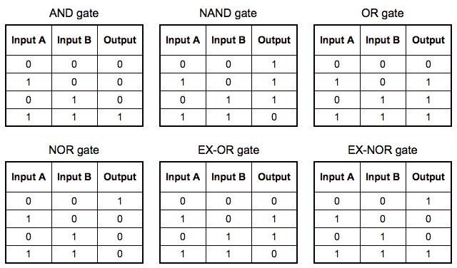

Hello,
Did you read the component datasheet?
The operation is of the Exclusive-Or (XOR) type, so when the inputs are in the same logical state the output will always be in a low logic state.
Datasheet L9110

I tried the XOR logic as you have suggested, and it worked but not quite expected. I have some questions:

The motors would only spin and stop if I use HIGH for the halt() function. It would not work if I set all pins to LOW. Why is that so? Both pins HIGH and Both pins LOW should give 0, am I right?
