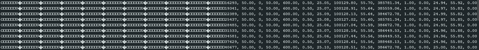

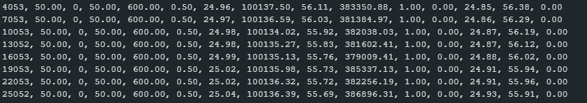

When I upload the code to ESP module from my desktop computer, I get the below output in serial monitor
When I upload the same code from my laptop computer, I get the below output in serial monitor
Any clue what could be wrong?

Ah, forgot to specify this.. when it is uploaded from Laptop, the serial monitor in the desktop and laptop shows the scrambled characters before the readings
And with the clean readings which I am getting when uploaded from desktop, I get clean serial output in both desktop and laptop..

Hello.. So now I got verbose output from both Desktop and Laptop
attached is from the Desktop.
Desktop_verbose_output.txt (490.4 KB)
I can see that the esp version is 2.0.16 in Desktop and 3.0.0 in Laptop, even though both has 3.0.0 installed. Could you also have a look if this is causing or if there is anything else.. Sorry, since the number of characters are more, system not letting me paste the code here. So I am attaching the txt file
Way beyond my skills. Try to answer the person who asked verbose output.
Anyway, I expect having two core versions installed and using the older one is not good thing.
Different esptool version also.
Oops.. my bad.. sent to wrong person.. :grinning:

I can see that the esp version is 2.0.16 in Desktop and 3.0.0 in Laptop, even though both has 3.0.0 installed. Could you also have a look if this is causing or if there is anything else.. Sorry, since the number of characters are more, the system is not letting me paste the code here. So I am attaching the txt file
How are you verifying that both have 3.0.0 installed ?
OMG!! I just found out that the version on my Desktop is 2.0.16
I was only looking at the version at the bottom of the image.. :astonished:
Do you think that might be causing the scrambled characters in serial monitor?
I will anyway downgrade to 2.0.16 on my Laptop and test again today..
