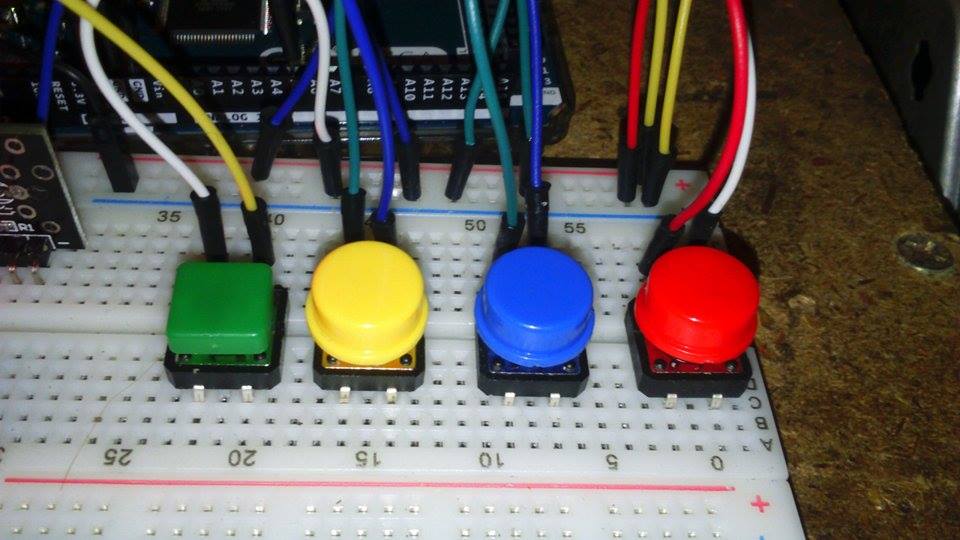

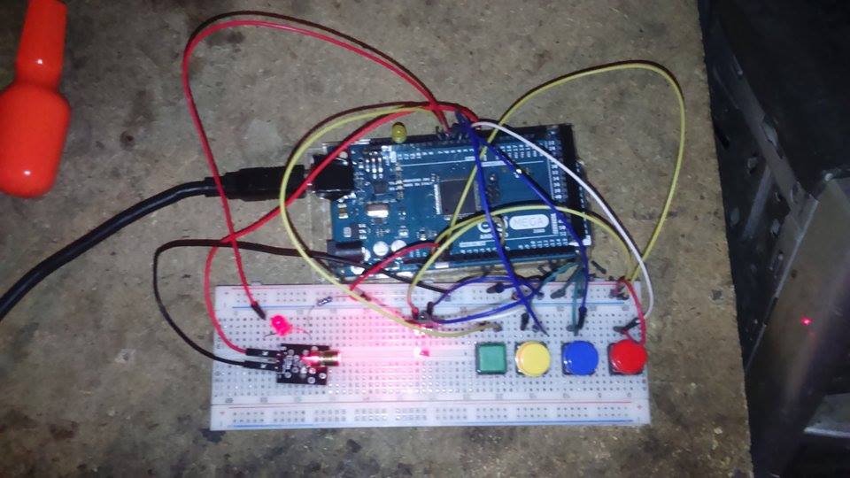

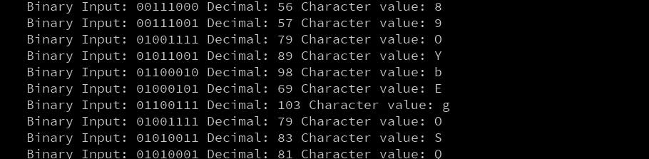

So I'm working on a project that isn't exactly useful to anybody but is just a really interesting way to create and display simple binary data.

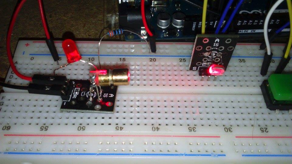

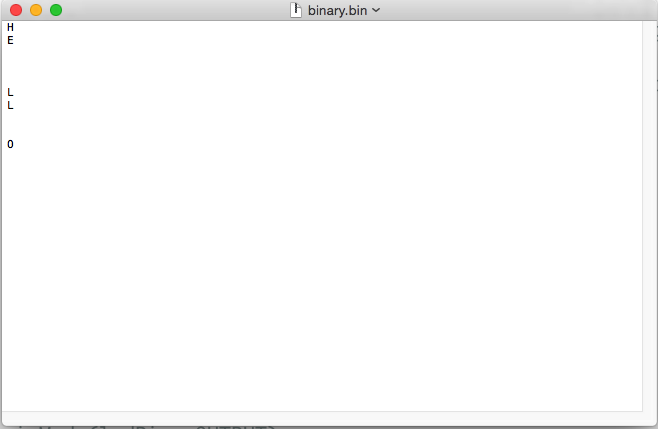

I have created what I call a 'Laser Binary Writer' or LBW. Essentially it is just a laser module pointing to a photoresistor. The Arduino takes in data from the photoresistor to generate either a 0 or a 1. If the photoresistor is receiving light from the laser, it generates a 1, and if not, a 0. It takes these 0s and 1s and places them in a string array, which gets sent to Processing. Processing then analyses the binary data and outputs the equivalent character from the ASCII table and saves it to a file. Sending multiple lines of data allows for a word or a sentence to be written and saved to a file, all from creating simple 0s and 1s from a laser and photoresistor!

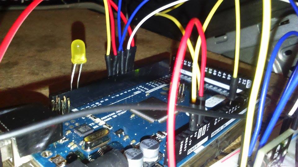

I'm wanting to take this quite a few steps further, but here's the Arduino code with the Processing code below. I've also attached some pictures of the setup for your reference if you'd like to recreate this.

*************ISSUES (1)***************
* Sometimes the 8 bits come through *
* split on the Processing side. I *
* don't know which side it could be *
* resolved on or whether it's both. *
