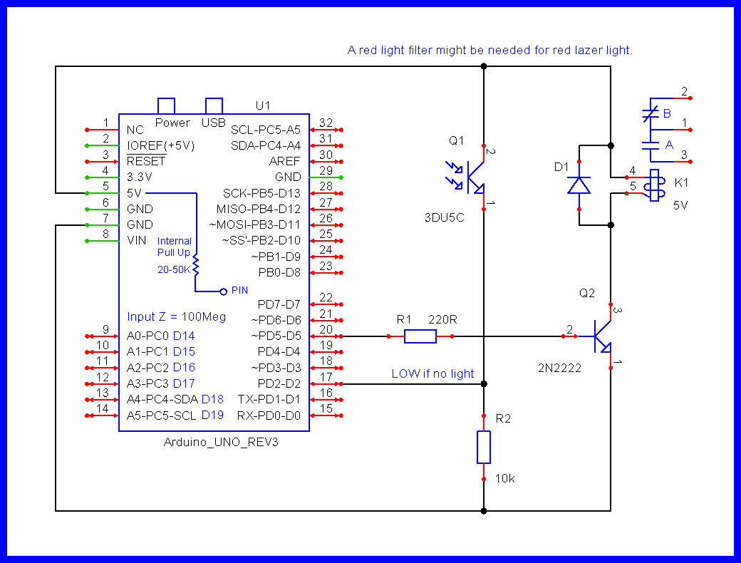

Hello to All,
I have code for Light Controller/Saver using LDR/Photo diode which is working perfectly.
Planned to implement same code for Laser Security System, is responding as supposed to be.But What I have observed
if Object crosses Laser & LDR/Photo Diode Quickly.
System failed to detect those quick/short pulse from object.Please help me.
Blink without delay code was also tried but not fruitful
Following code is being used:

delay() means do absolutely nothing, especially not "detect sensor activity".
Study this tutorial to learn how to get rid of all those delay statements: https://www.baldengineer.com/blink-without-delay-explained.html
Sir, that was too used ...issue is detecting fast/quick passing object
The code you posted can't possibly work, because it spends 99.999% of its time doing a useless delay(), instead of reading the sensor.
Post your best attempt at fixing the problem.
LDR or photodiode?

LDR's are very slow. Photodiodes are fast. It matters which you are using.
Infact I started with LDR but it seems lazy nature . So I used photo diode with changes in hardware circuitary.
Sir, very true thats why now I have been using Photo diode
Please post a hand drawn, clearly labeled circuit diagram, with component values. If you are using sensor modules, post the links.
Why are you still using delay()?
Ok Sir, I will remove delay ,shall test on hardware circuit soon .
Not sure what your requirements are.
If you use a Photo Transistor, they can easily respond to an object that moves by in 5ms.
You would use a regular digital pin to monitor for these detections.
Example:
You can buy a 3DU5C Silicon Phototransistor for 10/$5.00
Thanks,I will try as you suggrested.
Typical sketch:

Thank You Sir, I shall try it.
Once again ,Many thanks...working smoothly in my project....God bless you greatly !!!
