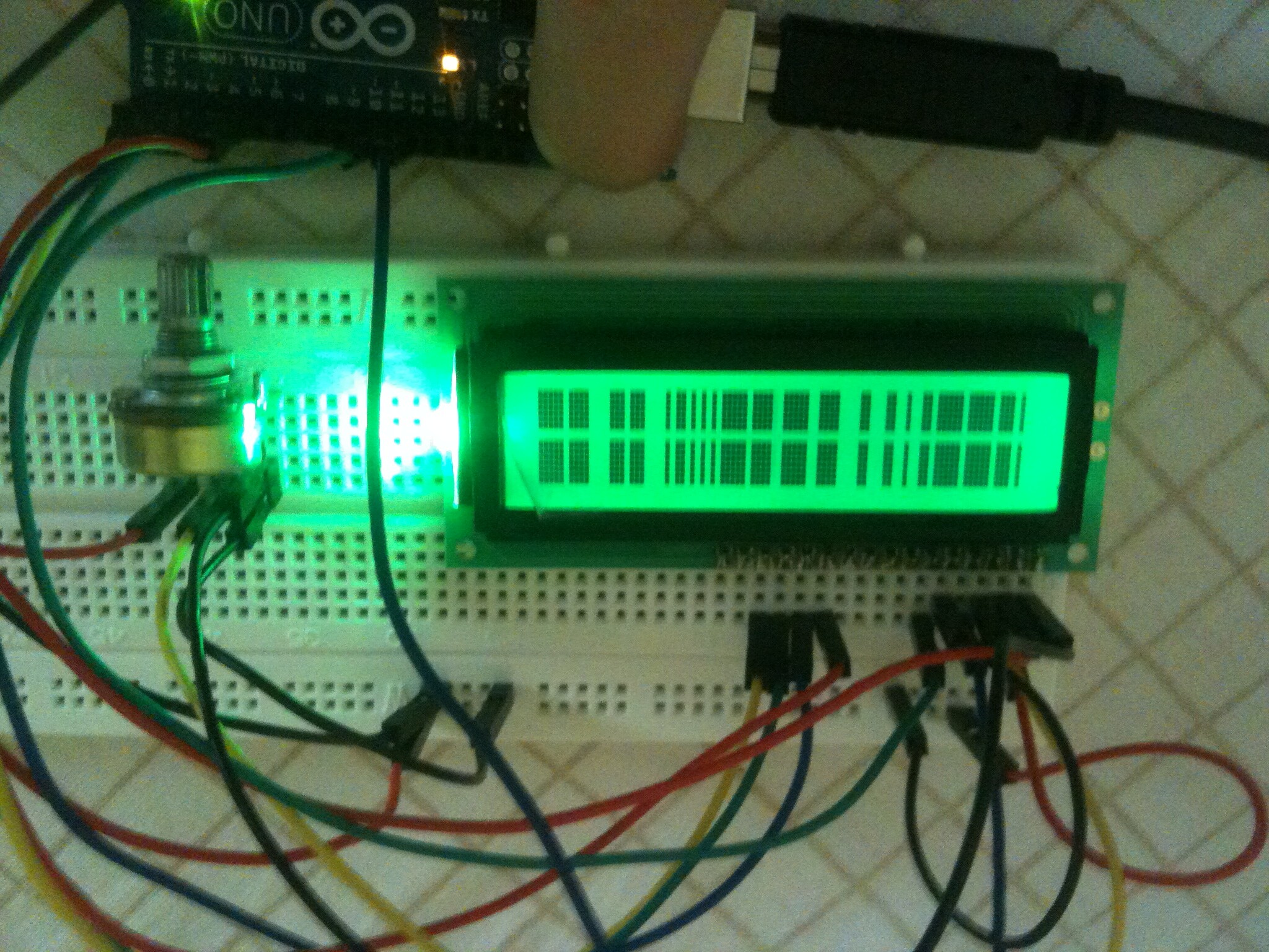

I just bought my arduino, and I was following a project with the LCD screen. The first time I used it, it was working perfectly. Then e turned it off, and at the other day, when I turned it on again, the screen had some failures. Some of the "lines" were note been showed. What could have happned? I tried to rebuilt the circuit, but it didnt work. I cant believe it has broken by itself during the night!
Did you try adjusting the contrast? Post a picture as I can't see your LCD from here.
Yes, I already had ajusted de contrast. As you can see by the picture, not all the lines are working.
This is most likely caused by a problem with the contacts between the PC board and the LCD 'glass'. Try putting some pressure on the black bezel around the display and see if the display changes.
Also, I think your backlight needs a current limiting resistor and the lack of one could be causing some power supply issues.

Yeah, the display changed when I pressed it. How can I fix this?
Did it display the correct information?

Not exactly, some of the lines appearead, some of them desappeared. It changes depending on where I press it

Not exactly, some of the lines appeared, some of them disappeared. It changes depending on where I press it
It's a dud. Take it back.
