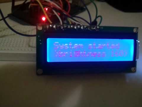

Firstly thanks all for the help on this issue.

Your probably right it does not need adjusting once correctly set so a resistor or pot would suffice. I intend on using the LCD is varied light environments and power sources so it would be convenient to change the contrast and brightness via PWM (a pot would also do but is less cool!).

Thank you for this! Along with this tool (http://sim.okawa-denshi.jp/en/CRtool.php) its easy to make an RC filter. I used your suggested 47uf capacitor and 1k resistor to make mine and the results are good:
No RC-Filter
+RC-Filter
And images
By brenwildaust at 2011-06-12
Thanks again
  1. Let's trim off the excess lead on the soldered pins. They look almost touching on another at places.
  2. Back light is really bright. What resistor did you use?
I find my blue display with white letters sluggish and impossible to read without back light I wonder if it's the same with yours. I typically go with green or yellow display with black letters now.
