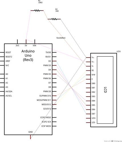

Thanks a lot and again a lot, but I don't sure if i get it right can you please check this pic if it's right? Thank you.
EDIT: smaller images
I'll tell you what why not post the picture even bigger then no one will have any chance of seeing it.
No, you only need one 10K resistor, from Vo, the contrast pin to ground.

I'm sorry, but this is NOT how he should connect his LCD since his LCD has its pins at the lower left, not the upper left, and the pinout of his LCD is non-standard. His pins are numbered 14, 13, 12, . . . 3, 2, 1, 15, 16.
What we really need is a clear photograph of how his LCD is actually connected.
