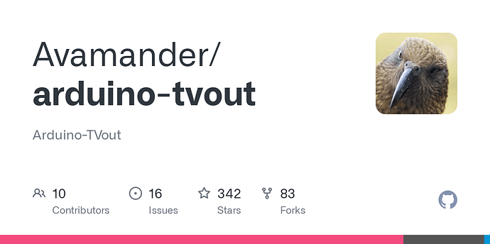

What about an old LCD TV? A Nano can generate a black & white video signal and use that to display large and small text.
