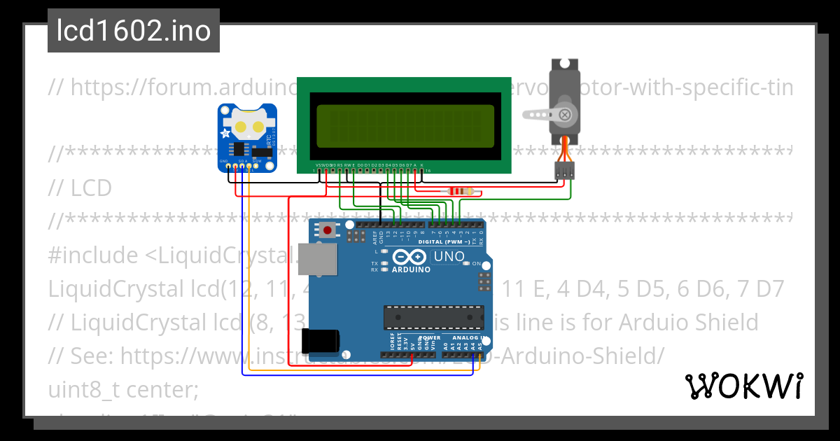

Hello @rodrigo_dl,
Timing with millis() gets easier as you use it more.
Timing with an RTC might be a lot easier, and better for refrigeration.
I made this "Pet Feeder" for a Arduino Forum user... You can see the RTC setup at the top, and how two alarms are set (hours/minutes), and when the alarms make the servo "feed" his cat.
You could build your own sketch from parts of this to "turn on/turn off" your refrigeration.
