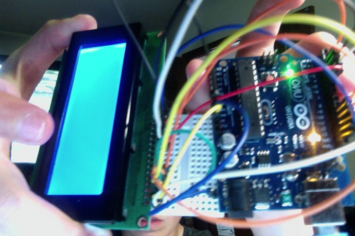

OK so i recently purchased a 20x4 LCD made by Hacktronics http://www.hacktronics.com and i set it up with the following tutorial Arduino Character LCD Tutorial I then ran the code on the page and changed the 16,2 to 20,4 and uncommented the lines yet this is not working. The LCD lights up blue but no text is displayed. Im using 330 ohm resistors (im not sure exactly, but there blue with pink and black stripes) but nothing seems to help it. Thank you to anyone who might be able to help!!

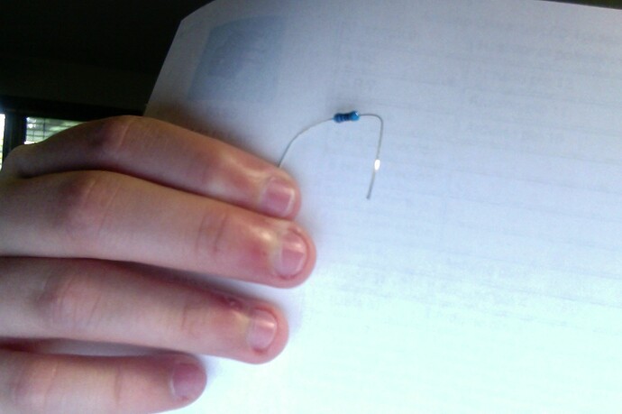

EDIT: In the picture my resistor is not shown because i was trying other things to see if it would work, heres a close up on the resistor
We need a clear (focused) picture that unambiguously shows both ends of each wire that connects between your Arduino and your LCD module. It would help if the picture were oriented properly instead of being reversed. (Use two mirrors if you have to.)
Where is your potentiometer?
What size is the resistor and where are you using it?

I guess you didn't solder the male pins to the display. Did I win a price? :wink:

Ok so Im really new to this stuff, does anyone know of a tutorial or something to help me? I don't know how to get my petentiometer to do anything and I copied the picture on the website exactly and now the LCD won't even light up, I don't know what "size" the resistor is either. I'm sorry

Try the Tutorial at Arduino Tutorial - connecting a parallel LCD. Be careful with the backlight connections, the text tells all about the resistor but it does not show up in the photographs. It goes in place of the red wire at pin 15 or the black wire at pin 16.
On a second look maybe you did solder the pins. The picture was not good enough to convince me but since you didn't say anything, I take it as yes you soldered the pins.
Your breadboard is very small, but you have not used the other half of the board. There's plenty of space to set up a potentiometer.

Alright so i did this and followed a tutorial but its still just lighting up as a blue screen. I think the problem is that the contrast is not working. ARRRGGHHHH! I'm frustrated, thank you for your help. Is there any pictures i could post that would be helpful?
Yes. See Reply #1.
