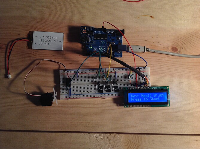

Howdy All,
I'm working on an Automatic Pet Feeder. Just starting out, i'm working on the Menu and it's interface that uses a 16x2 LCD (from adafruit), and 3 push buttons.
As far as code is concerned (my .ino is attached), i'm using the increasingly popular Menubackend library. I've adapted it to my project, but my current issue is as follows;
How do I remove the 500ms button push event lag without interfering with the debounce code?
As it functions now, I have to hold down the switch for 500ms before it recognizes the button push. If I shorten the debounce time, it understandably starts to simply scroll quickly through the entire menu. Is it just as simple as adding a break in the correct place? Or do I have to restructure the code?

My Current Hardware includes;
Arduino Uno R2
Adafruit 16x2 LCD
Adafruit DS1307 RTC
Futaba Micro Servo
3 Momentary Switches with 10k pull down resistor
3.7v Lithium Battery (I'm waiting for the 3v-5v step up module to be delivered, and this is for battery back-up anyway)
