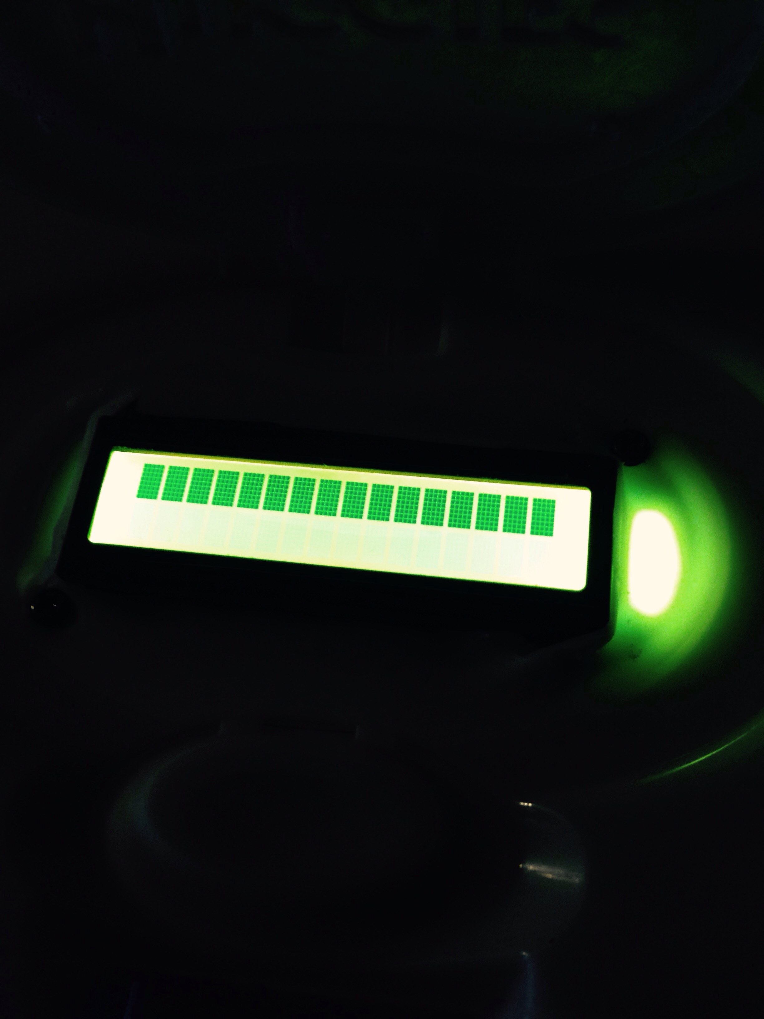

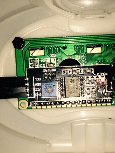

i have a small green backlight lcd display with a breakout module i beleave its called anyway its has , VCC, GND, SDA,SCL SDA is pin 20 and SCL pin 21 on mega the lcd just stays glowing and no text appears i downloaded the liqudcrystal library i could find and im using this code

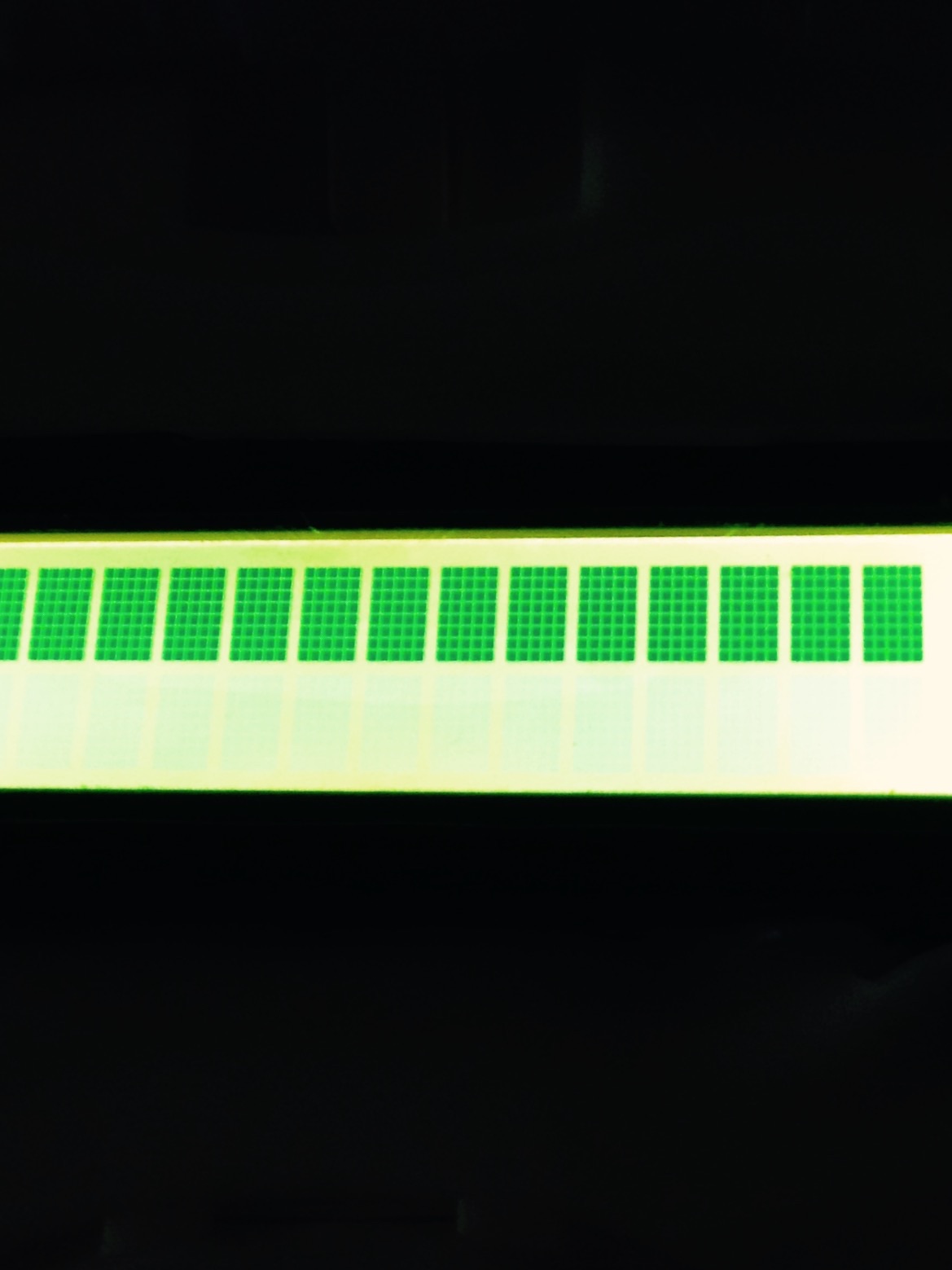

yes i adjusted it and now the backlight is off but its displaying a bunch of black squares across the top line
Maybe try another lib: here
If you do not get it working we need much more info:
= URL to display
= The Arduino board you are using
= maybe a pix or two of your connections
Yes backlight working but still only show black squared
Check the R/W wire link to similar
Other links stated wiring issues/
Ray
It doesn't look like they are using the ic2 adaptor
