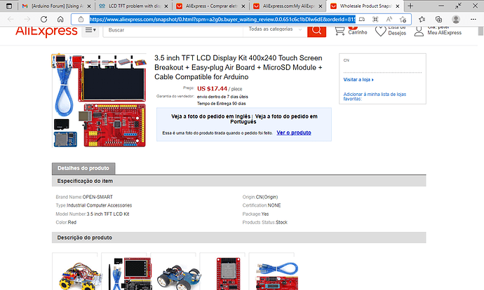

Please post a link to the actual board that you have bought. e.g. Ebay sale page.

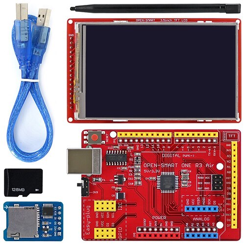

Have you bought the red "OPEN-SMART UNO R3 AIR" board to go with it ?
I have the bare 3.3V ST7793 board from Open-Smart.
David.
https://www.aliexpress.com/snapshot/0.html?spm=a2g0s.buyer_waiting_review.0.0.651c6c1bbEMk1N&orderId=8151009812106129&productId=32964204802
This is what i bought .
I will upload front and back of lcd
Yes i did buy that one, at least, its that description
Your link fails. Just click on your order history. Click on the item you bought. Post the URL of the item page.
Otherwise just describe in words.
e.g. red display pcb with 16x1 header.
e.g. red "OPEN-SMART UNO R3 AIR" board
David.
i
Here is the link, dam AliExpress APP doesnt like to share HTML.
Thanks for the link. That is exactly the same as my display + AIR.
Make sure that you switch GPIO to 3V via toggle next to USB on AIR board.
  1. Install MCUFRIEND_kbv via IDE Library Manager.
  2. Edit utility/mcufriend_shield.h for USE_SPECIAL
  3. Edit utility/mcufriend_special.h for USE_OPENSMART_SHIELD_PINOUT_UNO
You will find that PORTRAIT_REV and LANDSCAPE_REV are wrong in v2.9.9-Release. This is fixed in the current Beta.
