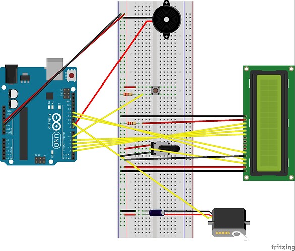

Hi to the Arduino community! I just received the Arduino Starter kit this week and electronics is new to me but not programming because I'm a programmer. After making some of the 15 projects in the starter kit, I made my first own project, an "Automatic Fish Feeder" or at least a prototype XD and I made a Sketch of it. All the components I use are from the Starter kit. Everything works well until the music start, the lcd screen display suddenly weird characters so I really don't know what's happening. There is my code, a picture of my project and a sketch I made with Fritzing. If you have questions or need anything to be able to help me, just ask :wink: Thanks!

Nothing to do with your code it is a hardware problem.
Looks like it is a power supply issue.
Try a decoupling capacitor on the LCD like you have on the servo. Also try a 100R resistor in series (in line ) with the buzzer.

Your LCD can't possibly work at all with pin 5 connected to +5v. How much else is incorrectly shown on your picture?

I tried a 220 Ohms (because I don't have 100 Ohms resistors in the starter kit) resistor in serie with the piezo as @Grumpy_Mike recommended me to try and it works like a charm now! Thanks for your help :D!
@floresta Yeah I made a mistake in my sketch, the pin 5 of my lcd screen goes to ground, not +5v. Sorry!
The piezo is highly capacitive. It is like tying an output to ground with a capacitor. Even worse is that you connected the piezo to Vcc instead of ground! When the output switches, it momentarily finds an almost short circuit as the capacitor charges, and draws the maximum current it can, causing deep transient on the power lines, internally to the chip if not externally. The resistor limits these impulses and resolves the problem

I noticed this problem can be easily fixed if you connect the piezo/buzzer ground directly to one of the three available Arduino ground pins, instead of using the ground row at the protoboard as the projects book says.
