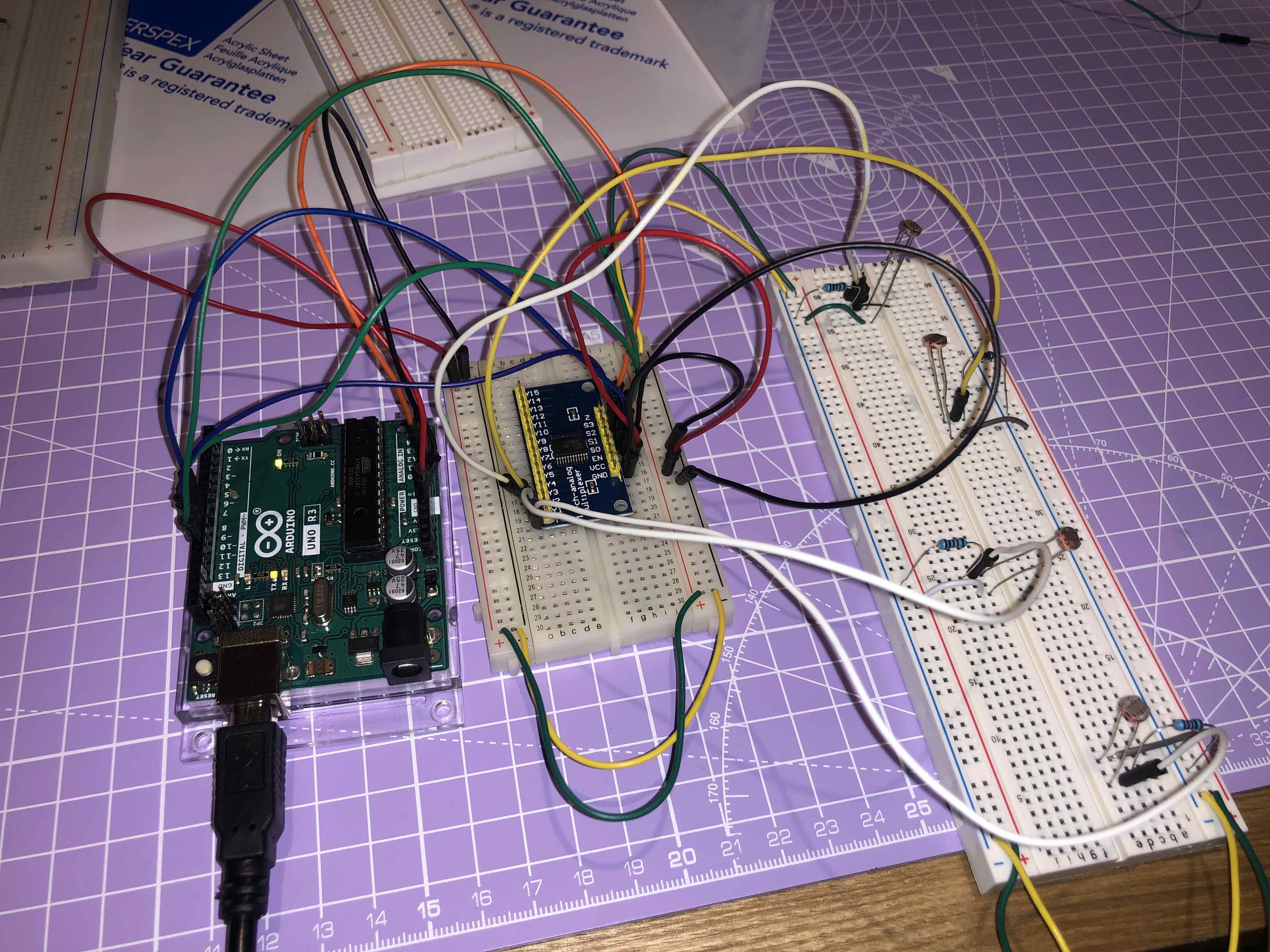

Hi everyone,
Attached you can see the code and the setup of my arduino and 16 channel analog multiplexer.
Currently, I am attaching only 4 LDRs, but my goal is to have 12 LDRs and receive their values on the serial monitor of arduino(so only have them as inputs). Then these values will be taken to MAX MSP to have audio as output.
I am having a problem getting the right values on serial monitor. Can anyone help me to spot the mistake?
Thank you for your time. Any help is much appreciated!! Been reading many forums and tutorials but feeling very stuck.

Your code is incomplete.
What values do you expect to see?
What values do you see?
Try two readings per LDR, and throw away the first one.
I am trying to get light level values (light intensity) for each pin (it will be 12 in total). So numbers ranging from 0 to 1023.
What do you mean by two readings per ldr?
I mean, after selecting the mux channel, take two ADC readings, and discard the first.
What values are you seeing?
I am so sorry, I am very new to arduino and trying to understand what you mean. Do you mean dismissing the PORTB values? like this?
Also attached the serial monitor screenshot >

Cannot make out where 5v and GND are connected to the solder-less breadboard power rails.
Row 57 LDR is not connect.
It’s best if you use red wires for +5v and black for GND.

Okay I see. Where do I connect EN, VCC and GND of the mux then? Not to arduino directly?
To the breadboard power rails.
Okay -> I think this is right? Still getting random values in the monitor
Do you have a volt meter ?
If so, measure the voltage across an LDR with light and without light.
Do this for all the LDRs.
Confirm the voltage varies with a change in light intensity.
Okay, just tried for all of 4 ldrs. The voltage varies once the light intensity changes.
What voltage do you get with light and then without light ?
Confirm the multiplexer PCB plugs into the solder-less breadboard, i.e. the mux pins need to actually go into the breadboard by at least 1/4 inch.
These images are very concerning.
The pcb header pins seem to be too long, they rise quite high above the breadboard. Are they soldered to the module?
4.5-4.7 -without light for all; 1.2-1.35 for 3 ldrs and 2.5 for 1 ldr
// Confirmed
They are not soldered- it looks like in the attached picture
