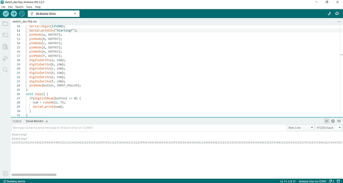

I just pressed the button.

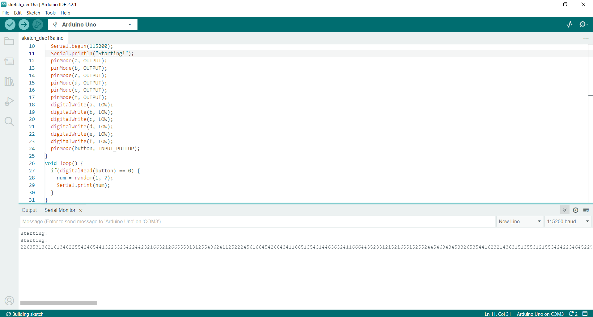

Wait I can add a delay so it doesnt print one million numbers
Ok, good.
But please don't post images of serial monitor. Copy the text from serial monitor and paste it into your reply, between code tags.
Then digitalRead(button); does not equal zero

Alright sorry
yes i know i forgot to ACTUALLY press the button :expressionless:

I don't think i did it right it's not printing anything now

Starting!
226353136216134622
It's working now, i put the delay at 300, which feels normal for me as i don't accidentally press it too long and print more than 1 number.

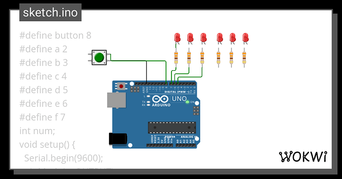

Huh? When i put:
num = random(1, 7);
none of the LEDs light up when i press and even hold the button
Post your latest code.

You seem to have lost the Serial.print() again.
ooooopsies
Ok

But its still not working when i push the button even with random(1, 6);
But is it printing anything?
Is anything being printed in setup(). If not, could that be because you lost some other lines of code?
By the way, to display a dice, I would say you need 7 LEDs
