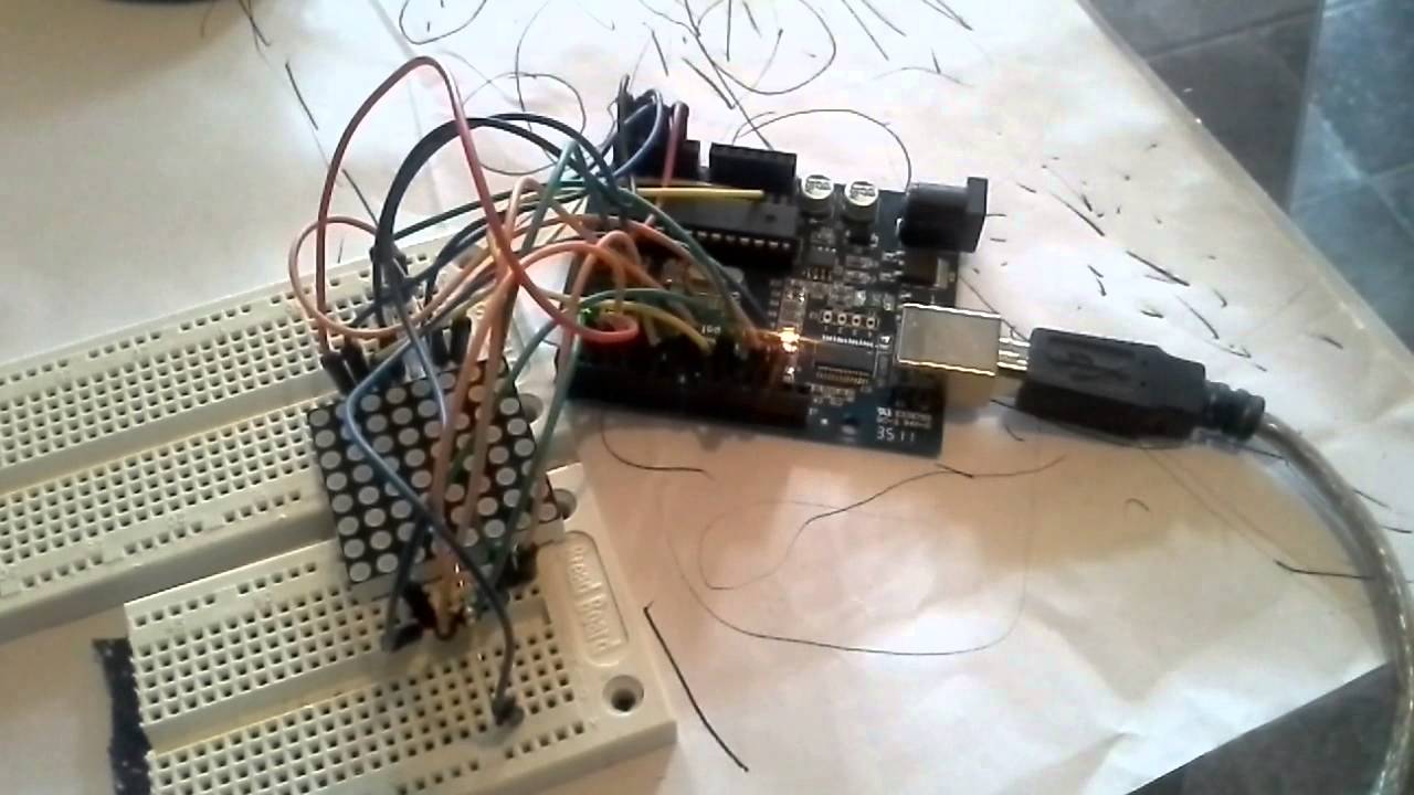

to my Arduino is working fine just perfect , but when im trying with flying message is not working only random dots are showing
please maybe some of more experience people will help me.
this code
is only a part but is making me crazy
// pin[xx] on led matrix connected to nn on Arduino (-1 is dummy to make array start at pos 1)
int pins[17]= {-1, 5, 4, 3, 2, 14, 15, 16, 17, 13, 12, 11, 10, 9, 8, 7, 6};
// col[xx] of leds = pin yy on led matrix
int cols[8] = {pins[13], pins[3], pins[4], pins[10], pins[06], pins[11], pins[15], pins[16]};
// row[xx] of leds = pin yy on led matrix
int rows[8] = {pins[9], pins[14], pins[8], pins[12], pins[1], pins[7], pins[2], pins[5]};
is part of code from arduino website with FT.1.
and when i change the col and row to my one is not working

i'm trying using with my 8x8 matrix direct from arduino i don't want to use m7219  for now.
i'm changing pins on row and col. like iv got col 1 rwo1 col 2 etc.
and is not working i will post you tube movie to show what iv got on screen but the first code is working fine , and when trying with this is not working and the pins are correctly
and i don't understand the pin[xx] why the are on this order
movie got first code and the last code with scrolling
I assume you got the code from here
http://playground.arduino.cc/Main/DirectDriveLEDMatrix
From the video I notice you have no current limiting resistors that page says:-
Note: DON'T FORGET CURRENT-LIMITING RESISTORS.
They won't stop it from working but you could damage the arduino without them.
I noticed that you changed the pin assignment
// your code
int pins[17]= {-1, 18,17,16,15,2,3,4,5,13,12,11,10,9,8,7,6};
// original code
why is this?
Yes i was using all that whole set of. Res.
I was linking with original code .
And didnt work but yesterday i find code wich is working fine i will post soon

i hope this will be helpfull to someone, i did it
i found this code have some bug if you will place too long massege is getting mestup, im trying to sort this out
if you have any new codes post it please
