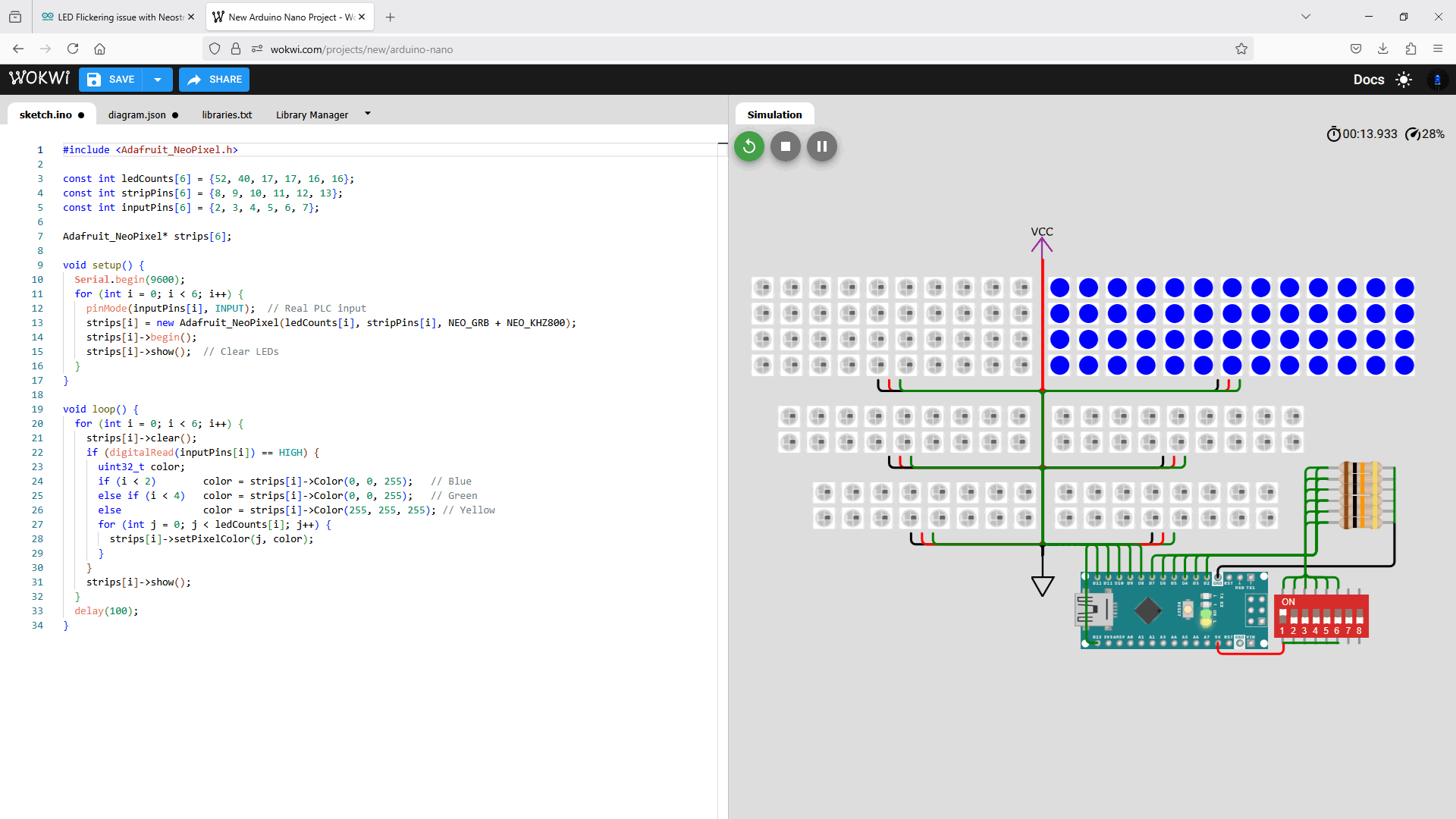

The below is the code, i tried making a project where i will glow 6 leds only after getting output from PLC, below is the code after using below code leds are glowing even without getting output from plc, and when output of plc is provided as input to the leds, leds start flickering(i.e High, Low simultaneously).
const int ledCounts[6] = {52, 40, 17, 17, 16, 16};
const int stripPins[6] = {8, 9, 10, 11, 12, 13};
const int inputPins[6] = {2, 3, 4, 5, 6, 7};
Adafruit_NeoPixel* strips[6];
  for (int i = 0; i < 6; i++) {
    pinMode(inputPins[i], INPUT);  // Real PLC input
    strips[i] = new Adafruit_NeoPixel(ledCounts[i], stripPins[i], NEO_GRB + NEO_KHZ800);
    strips[i]->begin();
    strips[i]->show();  // Clear LEDs
    strips[i]->clear();
    if (digitalRead(inputPins[i]) == HIGH) {
      uint32_t color;
      if (i < 2)        color = strips[i]->Color(0, 0, 255);   // Blue
      else if (i < 4)   color = strips[i]->Color(0, 0, 255);   // Green
      else              color = strips[i]->Color(255, 255, 255); // Yellow
      for (int j = 0; j < ledCounts[i]; j++) {
        strips[i]->setPixelColor(j, color);
    strips[i]->show();
  delay(100);
Unless connected to something, your inputs are floating, and will randomly read high or low. Make the pinMode call
pinMode(pin, INPUT_PULLUP);
and you will consistently get a high if the input is floating.

The input pins should be LOW by default. You can do this by adding external 10kΩ pull-down resistors from each input pin to GND or enabling internal pull-downs (if your board supports it — e.g., ESP32 or STM32).
On an Arduino Uno or Mega, internal pull-downs are not available, so you must add external resistors:
// Add this in setup if your MCU supports pull-downs (NOT Uno or Mega):
pinMode(inputPins[i], INPUT_PULLDOWN);

There is no need to call show() for every strip every time through loop(). Better to detect when the input changes state, and only call show() when the input transitions from LOW to HIGH or HIGH to LOW.
I am using PLC Siemens S7-1200, which has digital transistor outputs (sourcing type) — they actively pull the output HIGH when ON, and float or pull LOW when OFF.
The NeoPixel LED strip is powered by arduino 5V itself connected to MY laptop Via Cable
You need a much larger power supply. With a total of 158 LEDs, I would use a 10 amp power supply if there is a possibility of having all LEDs on full brightness with white color, although with your current code a 5 amp supply should be sufficient.

Your code simulates perfectly if you tie all your button pins LOW.
ezgif-4ea44bcab32185
click here for diagram.json tab for wokwi
