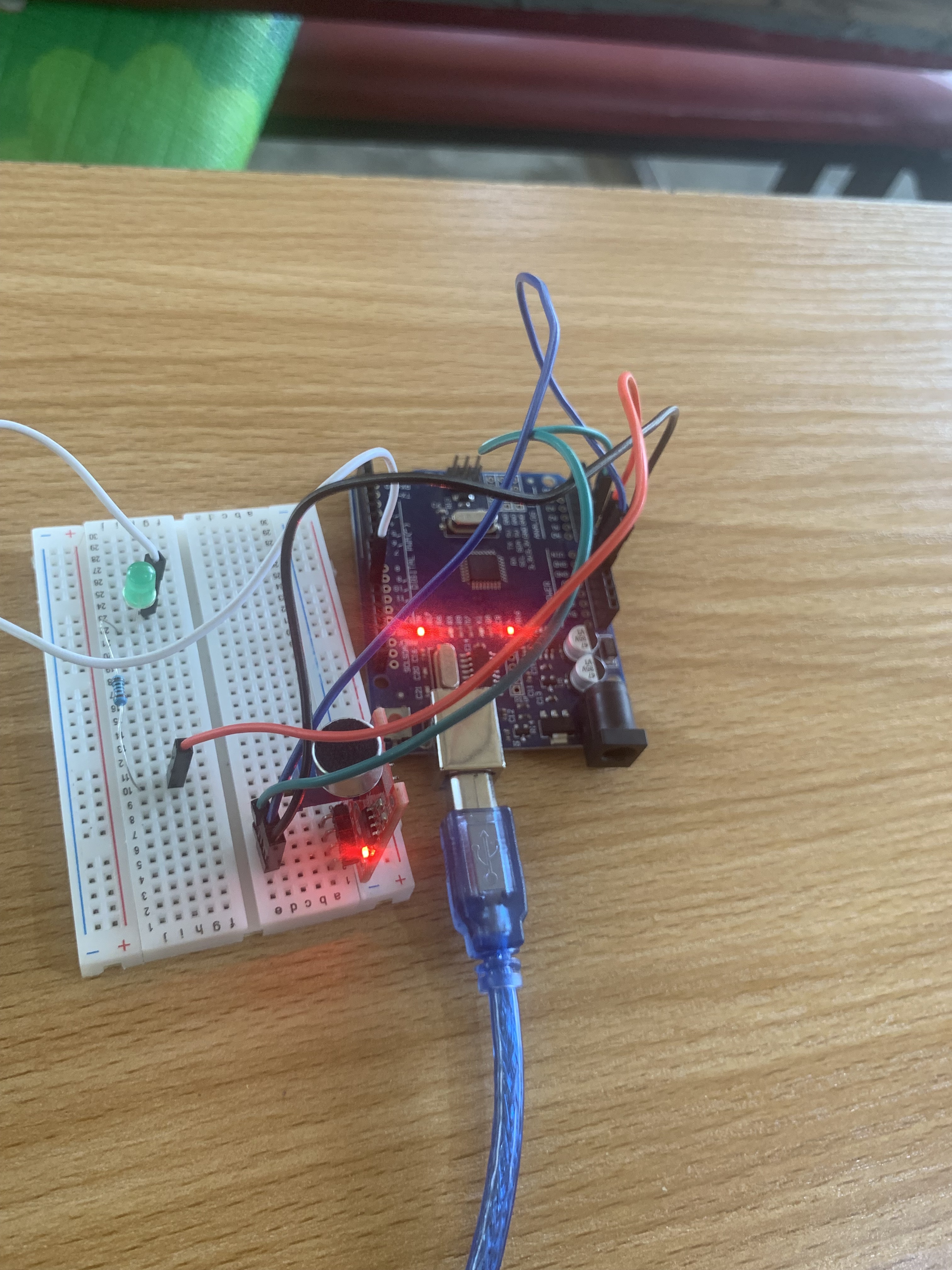

Sir, I have not been able to get a good schematic of the circuit due to network issues
But this is my connection below
  1. Sound sensor
    G to GND pin
  • to 5v pin
    AO to AO pin
On Breadboard
2.Led
Cathode with resistance to pin 11 and anode of led to GND
Product link
Purchased from Aliexpress
Please drop correction

  • Let’s confirm the LED is properly installed in the breadboard (looks like it might be installed backwards).
    Try toggling the LED with the Blink sketch that is in the IDE examples.
  • The LED should be wired similar to LED D2 in the image below.

Much better, before the sensor was "deaf" 99.98% of time
  • Does your LED turn ON ?
Yes sir
It comes on without waiting for the clap signal :smiling_face_with_tear:
