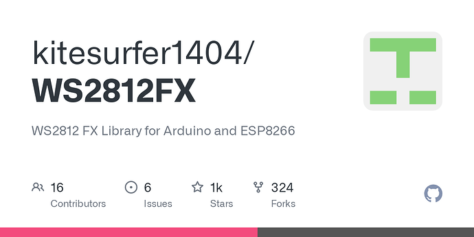

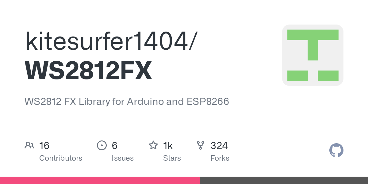

#include <WS2812FX.h>
This is not a library I have used. Where did it come from?

Thanks for the replies I appreciate it,
So I am using this library because it is an extension of adafruit, It just gives more effects and options for the project that I am working on.

The WS2812FX library does appear to use a considerable amount of memory, each strip is using 623 bytes regardless of the number of LEDs used, so the total needed for a strip would be at least 623 bytes + 3 bytes per pixel.

Have you a link to that library?
Sure its here,
Thanks for that.
The library is an add on to the Adafruit library. From what I can see of the library it is not written so you can have multiple instances of it. That is you can only have a single instance so it will not work with the multiple instances you can have from the Adafruit libiary.
You need multiple instances in order to have multiple output pins. So I conclude that this library is not compatible with what you want to do.
I see you have raised an issue on the GitHub but it is not concerned with your problems here.
