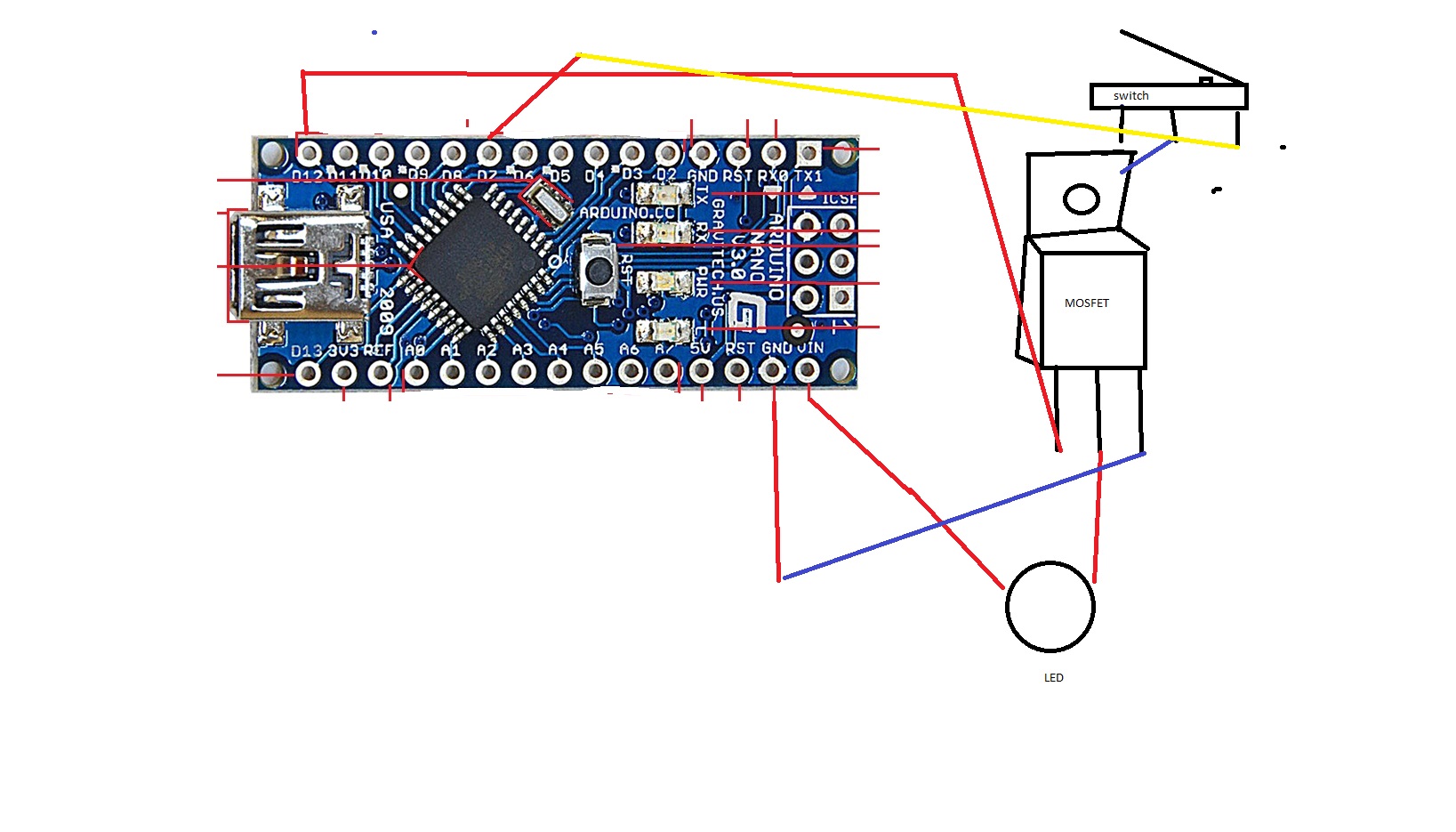

he guys so i have a mosfet attached to a led and then to my arduino nano, the first switch "D2" works fine the led its off then when the push switch is pushed on the led turns on now if i were take the switch out of D2 and put into D7 the led is on a bit dimmer and if i then press the switch it turns off? whats wrong with my code here???

You have to make buttonState2 equal to something, right now you make buttonState2 = 0 when you created the variable but then never change it.
 // variables will change:
int buttonState = 0;         // variable for reading the pushbutton status
int buttonState2 = 0;
Maybe you should put this somewhere :wink:
 buttonState2 = digitalRead(buttonPin2);
And remember the above line needs to be executed/updated now and then.

sorry about colors etc XD but here is how i have it set up currently i know im a paint pro XD lol
hmm this "img]Imgur: The magic of the Internet[/img" with brackets is on the forum but its not showing so here is the link:

ok so it turns out i needed to put the 3rd contact on the swtich to vin? and now it works but its dimmer that pin7?
OP's image:
What MOSFET are you using?
You do know Simple LEDs need a series dropping resistor.
What LEDs are you using?
Do you have two switches or one? :o
im using IRFB4110PBF N Channel Hexfet High Speed Power MOSFET

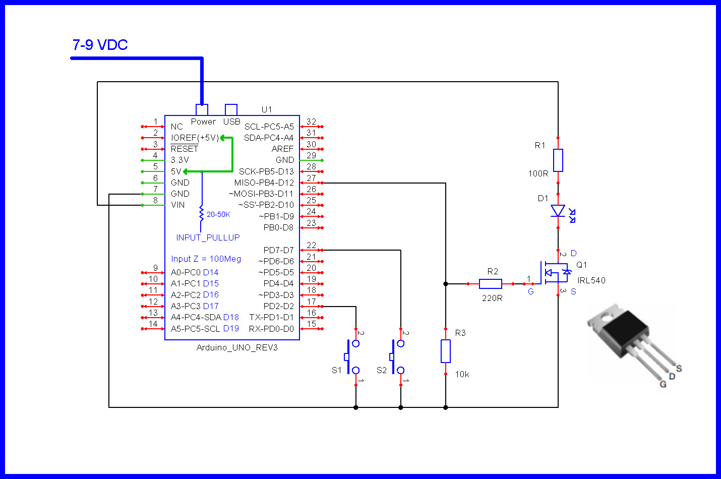

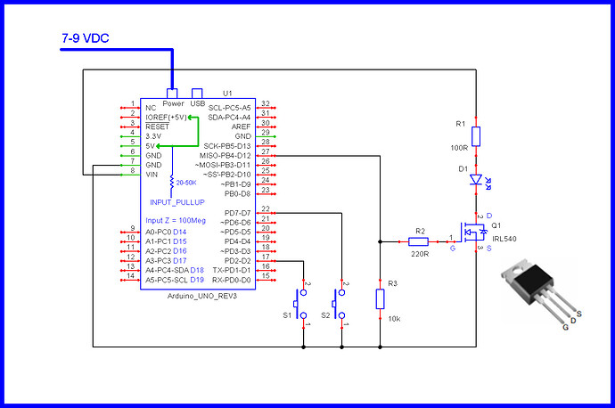

IRFB4110 is a poor MOSFET for the Arduino to control directly.
You need a LOGIC LEVEL MOSFET
This schematic might be what's needed, Note the MOSFET is a LOGIC level transistor.
BTW
Use:
pinMode(buttonPin1, INPUT_PULLUP);
pinMode(buttonPin2, INPUT_PULLUP);
