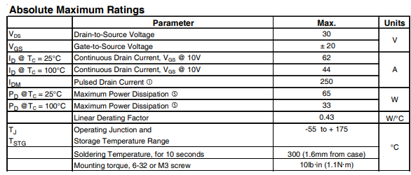

Some Datasheet specs for the MOSFET are below:

In remarkably good agreement with the data sheet specifications and a small voltage drop across the MOSFET. The circuit is working as expected.

I have no experience with that mosfet, but 0.3V across it may mean that it's not fully turned on. But if you're driving the gate with 5V, it seems like it ought to be, or at least turned on enough to do better than 0.3V.

No that is wrong. The threshold value is where is just begins to turn on the FET. It will be in the linear region and will get very hot. For the FET to turn on you need to exceed the voltage given in the Ron (On resistance) given in the data sheet of the FET. Which is 4.5V with a maximum current of 25A or 10V for a maximum current of 31A.
