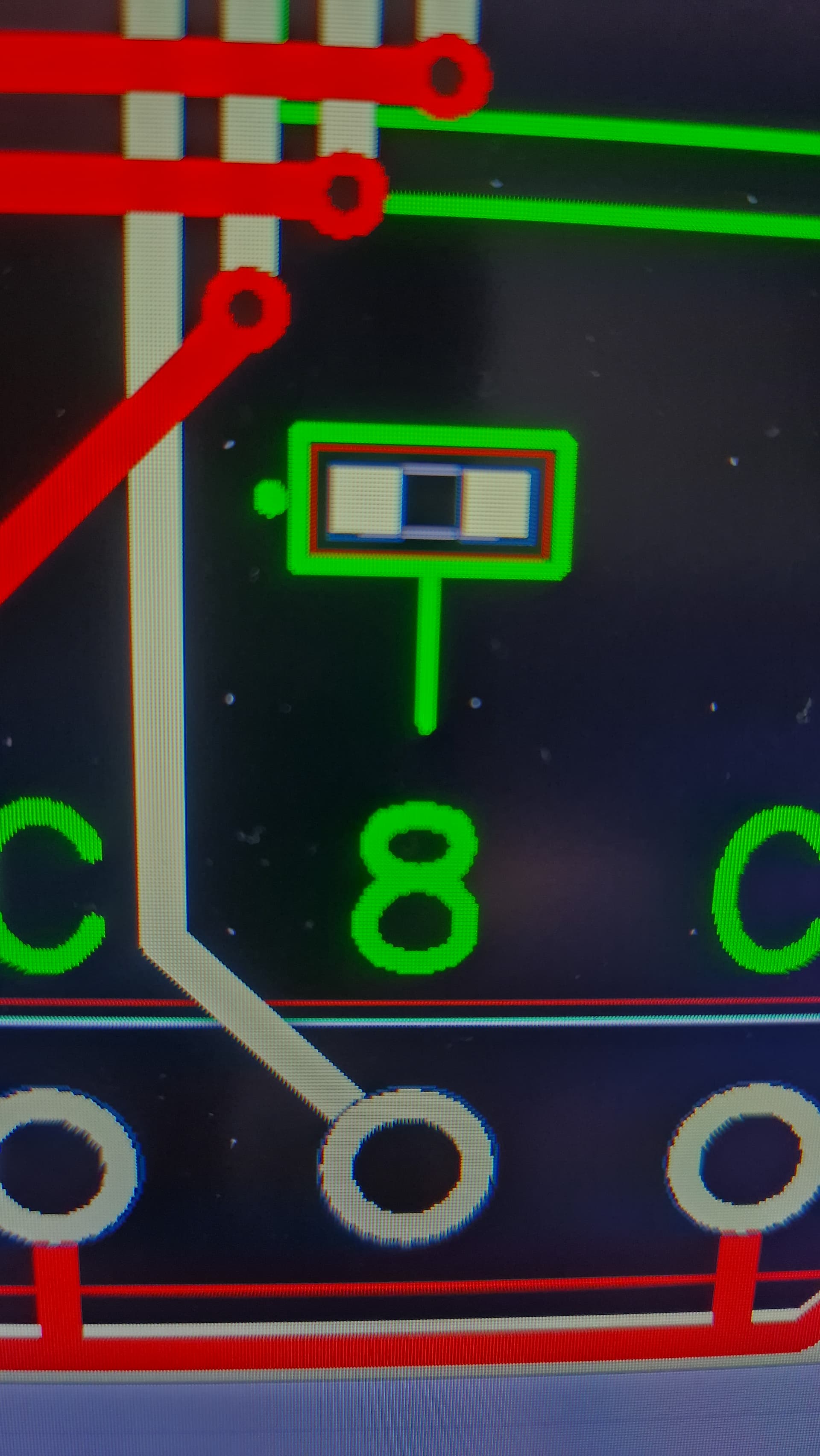

I am re-designing a PCB for someone. The existing circuit diagram in incorrect, so I am literally testing my way through trying to work it out.
The LEDs have the following silkscreen:
What is the DOT? I would have taken that as Anode, but the wiring tests it as Cathode (GND).
Can't find any reference in the data sheet and it's impossible to see the marking on the actual LEDas its underneath.
Usually the dot indicates pin 1. However, there is no fixed convention as to which is pin 1 in this type of footprint, nor is there a standard for which pin is marked on the actual device, it even varies for a single manufacturer.
I guess the most widespread convention is to mark the cathode on the device (same for polarised capacitors, and through hole devices). Pin 1 is often assigned to the cathode. That results in the device marking aligning with the PCB marking.
However without the schematic - footprint mapping, I think the only way to tell for sure is by examination of the circuit.

I have made my own symbol for the PCB and put a K and A so that it's obvious.
Thanks all
