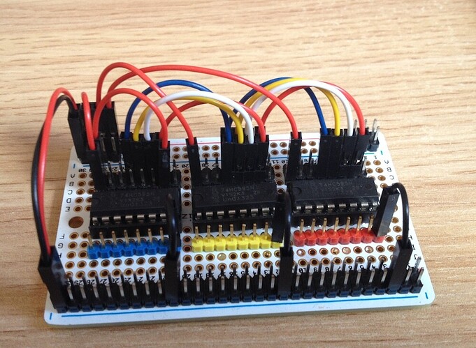

I've attached a picture of my perma board as I can remove and replace the IC's and change the connections as I'm using header pins rather that 'hard' wiring everything.
Could you please point me in the right direction in terms of which IC to purchase as eBay is bringing up DIP20's and DIP16's. Do the 20s just have more outputs?
E-bay = crap a lot of times. Digikey, or Mouser (often no sales tax), have parts in a few days vs weeks, parts traceable to manufacturer vs who knows where.
Look at TPIC6B595 (150mA outputs), 6C595 (100mA output), 6D595 (100mA output).

I've just ordered a TPIC6B595 just to experiment with as I think the 74HC595s will suffice for this particular project.
Given the details of my LEDs previously, I could use something like a 70ohm resistor with the TPIC6B595 to gain maximum brightness?
Also had a look at the data sheet and the pin-outs look completely different to to 74HC595!

You wire the tpic up just the same as the 74hc595. Both chips have all the same functions, its just that those functions have slightly different names and are on different physical pins. But clock is still clock, data is still data and so on.
