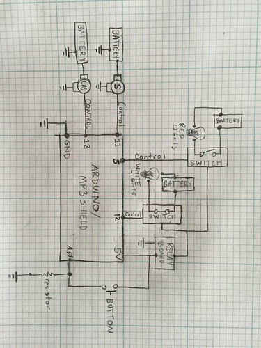

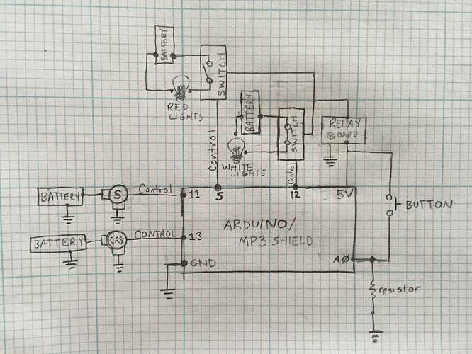

Post a schematic please. Hand drawn is ok as long as it is neat enough to read. Also details of power supply to the circuit. Are you powering all these leds and 2 servos from the 5V output of the Arduino for example?
Paul
Hi Paul,
Thanks for replying. The Arduino is only powering the button and the relay. Everything else (leds & servos) has its own battery supply. Working on a sketch now.
I have never drawn a schematic before, so please excuse my crude first attempt at one of these. See drawing attached below.
Few more details:
S = servo
CRS = continuous servo
LED lights came with their own battery packs that I have spliced in the relay
I wasn't sure how to represent that I currently have the Arduino powering the button and the relay switch board. Hopefully I did okay.

Your diagram (not yet really a schematic, but not bad for a first attempt!) shows pins 11, 12 & 13, not A1 A2 & A3... please clarify.
Ack. Sorry about that. I changed the pins from the diagram to be as follows:
A0 - button
A1 - continuous servo
A2 - regular servo
A3 - white lights
5 - red lights
