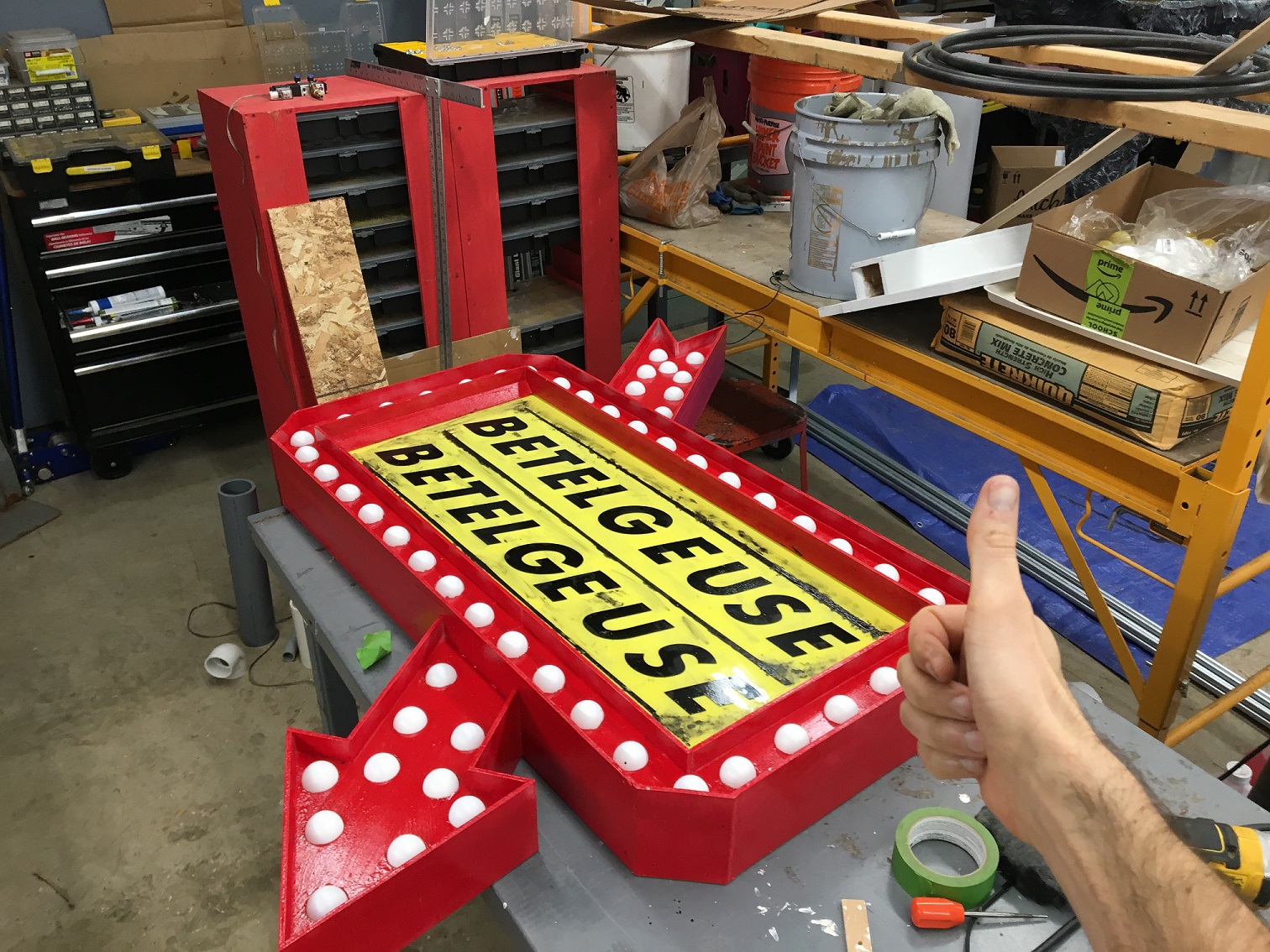

I am making a Beetlejuice prop for Halloween and after 20 hours of research and going nuts I decided to ask for help.
I need 11 lights of the "arrow" to chase each other. Then the outside of this sign will have LEDS wired in sets of 3 so they can chase on their own without interferring from the 11 chasing leds. I have figured out how to use Arrays to get the 11 to chase. I have figured out how to get all 3 outside LEDS to come and off on their own time at the same time. I can't get LED 28 to light, then LED 30, then LED 32, repeat (one at a time BTW).
Please help. Attached is a picture of the sign I am making.

Don't do that! You've locked up your code for a long period doing just one thing.
Think about states. What state am I in now? How long have I been in that state? Is it time to change to another state?
You can have multiple state machines happening independently. This millisecond it's time to change the outer LED's. At some other millisecond the inner LEDs will change. Maybe they both change in the same millisecond but the humans watching won't be able to tell that the second one was 0.001 seconds late to occur.

This should work...

So, what did I do to your code?
  1. ran the auto-format on it to get the braces lined up
  2. changed the names of the two arrays so that there's no "1" in any variable names
  3. changed the loop() function to just call two functions which do the work
  4. identified that "count" was the state variable which remembered which arrow light is currently on
  5. wrote the doArrow() function to just step through the counter once per X milliseconds
  6. identified that the outside lights are always all-on or all-off and a simple function can do both
  7. wrote the doOutside() function to give you independent on and off times
Some tricks:
a. The length of the arrays is really important. You don't want to run off the end if you change the number of lights at some point in the future. Make this a variable. Then you can use it in many places in the code.
b. Instead of writing previousMillis = currentMillis, I add the interval. That way it doesn't slip by one or two milliseconds over a long period.
Future ideas:
i. I seem to remember that the Beetlejuice sign was kind of flickery. You could add random stuttering or stumbling by randomly changing the milliseconds interval after each time it's used.
ii. Add more stuff. The Arduino can do a lot of other things at the same time.
iii. Make the lights fade out instead of just going off. This is a pretty big project as you have to use blink-without-delay to simulate PWM on the non-PWM pins. But the different on and off times shown in this example should give you some idea how to do it.

Yes. I have attached a picture (hopefully) of my sign.
MORGANS you are a genius! Thank you so much for taking the time to write all that out! Your code compiled on the second try and worked like a charm! Your notes were fabulous and allowed me to really understand what was going on. I had no idea you could write a loop code like you did. Made that super easy.
I ended up making the lights chase and then added another section that allows a solenoid to blink the lights behind the sign itself. I like your idea of adding fading and flickering. I honestly have a ton of stuff to build and might not have time to add that to the code. I will post of a video once I get this thing all soldered together.
Again, this is a great community. I like to think I am intelligent, but really struggle with coding.

It's not necessary to write the same value to signSwitch 3 times over in rapid succession. You only need to do it once.
The reason I spotted this is the name of the variables. You use outsideLen and signSwitch in the same part of the code when those two things aren't related to each other in any way.
So I was able to get it all up and running. It worked great once I used the code. I did have to use three transistors and a solenoid in the project as the Arduino was not putting out enough power to make everything function.
