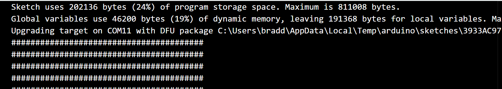

Post your full sketch, along with the build output (RAM present, RAM used, et c.). It will help finding the cause.
Here's the build output:
I have made a few changes since the start of the post but the primary issue (no blue leds when the DrinkHandler() State==Drinking) is still present. I noted there's no need for a timeout on the cometHandler(), because the various States have their own timeouts or otherwise exit when a button is pushed, therefore I just pulled that out. Here's the full sketch:

Calculations with mixed types can cause trouble (DrinkTimeout is an "int"). Configure/"type" DrinkTimeout as an unsigned long (and all the other ints doing math with millis() ) and see if calculations are effecting the color/range.
Happy to try that, but I guess it only affects the nodelay timeouts. Who knows it could help!?
I converted all startTimes and Timeouts to unsigned long. Same behavior. You know, all of the logic worked, including the blue led animations before I added the PDM and Inferencing from Edge Impulse. I was using a button to stand in for the detection of the keysound, which in this case is the sound of a dog drinking from a bowl. Now to debug, I have to lean my face down by this device and make a licking/drinking sound myself lol! I have some recordings that I used for training, but it's easier (but incredibly silly) to make the sounds myself :slight_smile:
Any other thoughts on this issue? I'm about to implement a workaround, have ordered a separate blue "noods" string from Adafruit and will use the one remaining GPIO to see if I can light it. So sad I can't figure this out :frowning: but will push through it.
