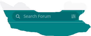

Hello
It seems to be a school assigment, isn´t it?
Take some time and search in the forum.
Last month we have had a quite similar request.
grafik
