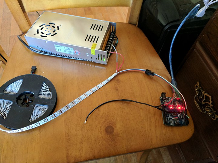

I have closely followed the configuration as shown in the below wiring diagram except I am providing no resistor for the data cable, and am connecting on pin 3 instead of pin 6: https://www.tweaking4all.com/wp-content/uploads/2014/01/arduino_no_computer_power.jpg
You may be thinking the power supply is overkill but I got it from a friend cheap (also brand new) and I plan to expand my project to have LED's supplied in the entire room...
Troubleshooting
As for troubleshooting that I have already done... I have a multimeter that I have run many tests on.
  • A continuity test on the LED strip proving that my +5V, data, and GND connections are good through the entire strip. All were good except the data which failed the continuity test from one end to the other. I think this is expected as it passes when I test the data-in to an LED and then the LED to data-out. I assume this behavior is due to the LEDs are 'off' during a continuity test.
  • A continuity test from the Arduino to the start of the LED strip to ensure my data connection was solid through to the LEDs
  • A voltage test showing that my power supply is providing 5V at the source, all the way through the end of the LED strip, and to the Arduino uno.
Based on those tests, I can assume that all of my connections are solid and all are receiving the expect 5V of power (although wattage/amperage is unknown but I expect to be satisfactory considering the PSU is rated for 350W).
Results:
As stated earlier I have tried this with multiple different sketchs uploaded to my arduino. All provide the same result...
When I power up the unit, I can see the Arduino turn on and the power supply turn on as well. This is also the point when I can successfully get a 5V reading through my LED strip - so i assume they are also 'on'. However, none of the lights actually turn on. Initially, I thought my data connection on the first LED was bad so I experimented a bit and soldered a wire to the data-in and connected that to pin 3 on the arduino. When I do this, the LED behind it (in this case the very first LED on the strip) lights up with mostly blue, a little bit of green, and no red but is VERY dim. Noticing this, I moved my data cable to the 4th LED data-in. This time LED 3 lit up with the same pattern (also very dim). From this, I am assuming that my LEDs work, but there is a miscommunication on how they should be turned on - IE something is wrong with my data connection.
I don't know where to go from here or how else to even troubleshoot this. Has anyone run into a similar problem before? Any potential ideas will help and even if it doesn't fix the issue, might help me continue troubleshooting... But for now, I am completely stuck and don't know how to proceed. Thanks in advance :slight_smile:

Not too sure I can see a common ground and capacitor.
I'm not 100% sure what I should do for this. But I have connected the ground of the power supply to the ground on the Arduino (as many places have said without this you could experience "blinking" unexpectedly) but when I add that, nothing changes.

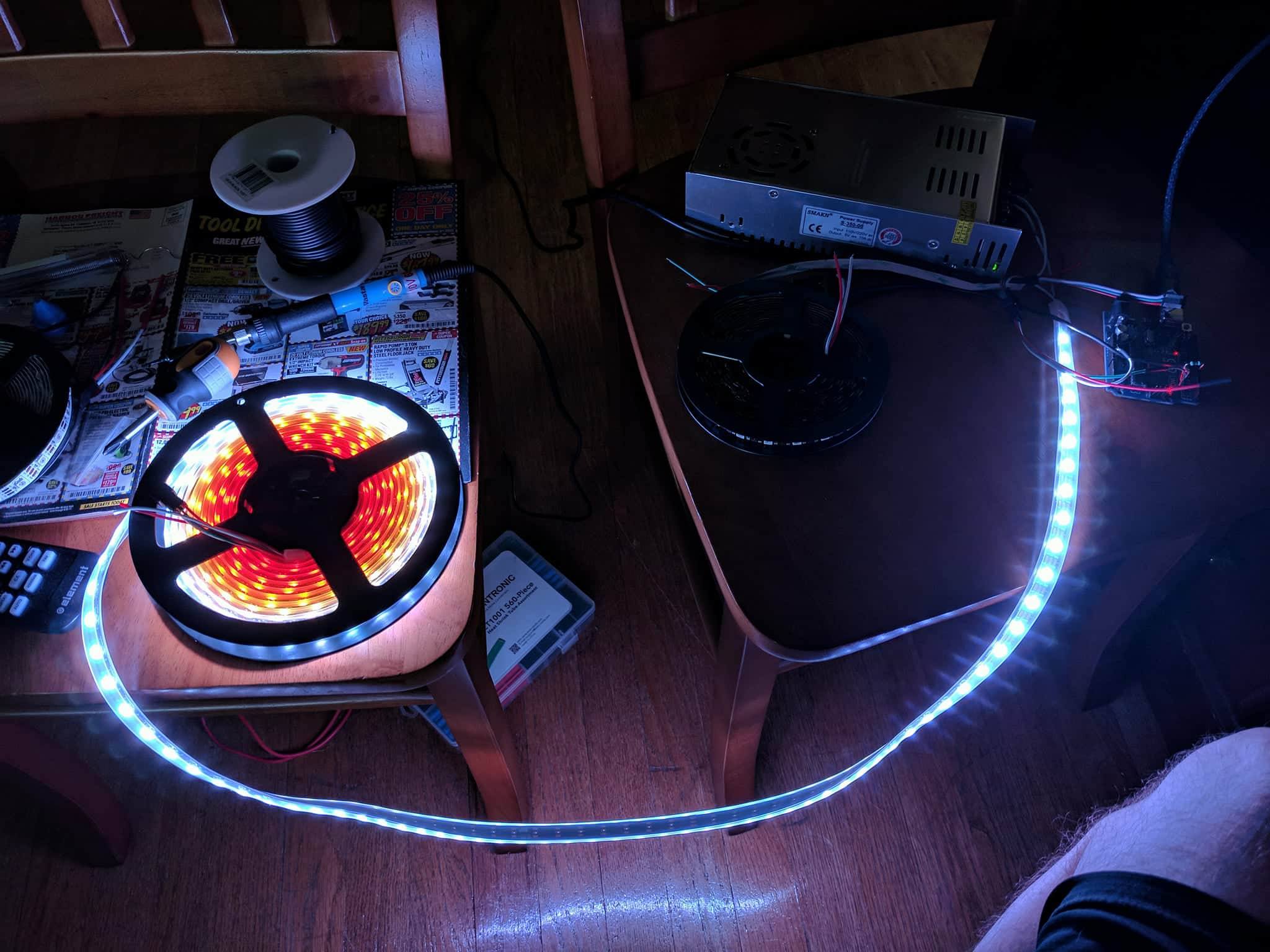

The LEDs have arrived and they turn on! Well... kind of.
About the first 75% of them have turned on. I have uploaded that sketch that I last posted here and the results are bizarre. Basically the lights look like they are about to start a rainbow effect but only about the first 25 LEDs actually rainbow. The rest of them just stay a solid color (or are just off). I also noticed that the very first LED stays white no matter what I do. Even when no data cable is connected, that first LED stays white and the rest stay off.
If I adjust my sketch to a lower LED count, lets use 6 as the example, it will reduce the amount that rainbow but it still wont rainbow the first 6 LEDs... It rainbow's about the first 4.
I have attached a picture to show what it looks like. Obviously since it's only a picture you can't see the rainbow effect but the only lights that are changing colors are the ones on the line coming out of the reel. By the time the reel starts curving back under itself, those lights are all stuck solid.
One more thing to add. I have tried both data pins 3 and 6 and they both have the same effect. Also, when everything gets all powered up, the lights don't all come on right away. It takes a few seconds before the LEDs closer to the middle of the reel start to turn on but they do eventually (minus the ones that are shown as black in my attachment).
Is there now something wrong with my Arduino? :o
EDIT: I noticed that my sketch was still using GRB and these lights are RGB. I changed that and noticed no difference however, now when I change my number of LEDs to 500 (instead of 300 which is what is actually on the strip) all the lights at least rainbow that are turned on. However, they ones that were off before are still off and the lights are still rainbow'ing even though my code has them all just turn to a solid red...

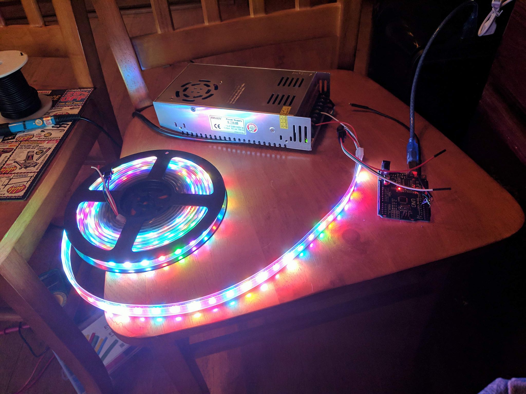

Update: I got a second arduino now as well in case that was causing the issue. At this point, I'm not sure if that resolved my problem or if it was something else... When I first hooked it up, I was getting the same behavior as before. However, I then came upon the FastLED examples that come with the library. I clicked on the "DemoReel100" (code below) and it seems to work!
That being said, my code that I posted here still does not work and I do not know why if it was working fine for you... I have now given the arduino the 'Adalight' sketch book and my AmbiBox application (which can run adalight in the background) can perform my screen capture, solid colors, dynamic colors, etc.
Studying up a little on that code I was able to get my own sketch working using the built in rainbow effect that comes with the FastLED library. See code below:

So, thanks to your help I think I may be good to go although I'm not entirely sure where my problem was in the first place which is mildly frustrating...
The last issue I'm having is some changing colors as the strip goes on. I'm wondering if this has to do with voltage drop or something similar but, the 'stronger' the color (white being the 'strongest' in this case, blues/reds being much less so) the less of that color is shown throughout the strip. It's not the end of the world but would be nice to keep color consistency. I'm just wondering if you know the reason WHY this is happening? (See attached screenshot for an example of me trying to turn the entire strip white)
That being said, it looks like the capacitor is only there to prevent power surges from the power supply.
Exactly the opposite. It holds up the supply voltage in the face of rapidly changing current demand. This is caused by the PWM or switching on and off of the LEDs.
See the power and ground coming out of the end of the reel? Connect this to the power and ground you are already using at the other end of the reel. That will help with power distribution.
