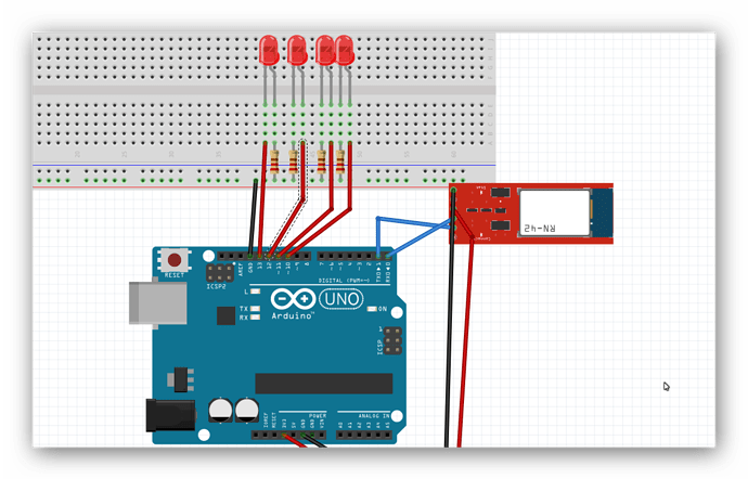

Hello world,
I would need your help related to the led completely turn off.
It was dim led after the loop. The led PWN is fine went to slowly HIGH then go to slowly LOW even I have tried the code see as below. Also, changed to both 255 from 256. The pin 11 refuse turn off the led either way... any idea?
let you know the Fritzing I made dont worry about the leds wrong placement anode and cathode or resister OHMS. please understand that thanks. if something else to addition the electrics components but i doubt it. more likely problems with codes.
on line 123 ( see the attach image)
case 11;
int r == 11;
for (r=0; r < 256 ; r++)
analogWrite(11, r)
delay(10);
for (r=256; r > 0 ; r--)
analogWrite(11, r)
delay(10);
real code if you need addition the information. please let me know.

it does work when I added as greater or equal than "r >= 0"
case 11;
int r == 11;
analogWrite(11, r)
delay(10);
for (r=256; r >= 0 ; r--)
analogWrite(11, r)
delay(10);
if I deleted
int r = 11;
it comes with error said "r" was not declared in this scope.

 PROJECT: ArduDroid
 PROGRAMMER: Hazim Bitar (techbitar at gmail dot com)
 DATE: Oct 31, 2013
 FILE: ardudroid.ino
 LICENSE: Public domain
#define START_CMD_CHAR '*'
#define END_CMD_CHAR '#'
#define DIV_CMD_CHAR '|'
#define CMD_DIGITALWRITE 10
#define CMD_ANALOGWRITE 11

void set_digitalwrite(int pin_num, int pin_value)
  switch (pin_num) {
  case 13:
    pinMode(13, OUTPUT);
    digitalWrite(13, pin_value);
    // add your code here
  case 12:
    int r = 12;
    for(r=0; r<10; r++)
    pinMode(12, OUTPUT);
    digitalWrite(12, HIGH);
    delay(50);
    digitalWrite(12, LOW);
    delay(50);
  case 11:
    int b = 11;
    for (b = 0; b < 255; b++)
      analogWrite(11, b);
      delay(10);
    for (b = 255; b >= 0; b--)
      analogWrite(11, b);
      delay(10);
  case 10:

Delta_G:
Then do it this way, the right way, and declare the variable inside the for loop.
for (int r=0; r < 256 ; r++)
this does work either way. hmm interesting...
