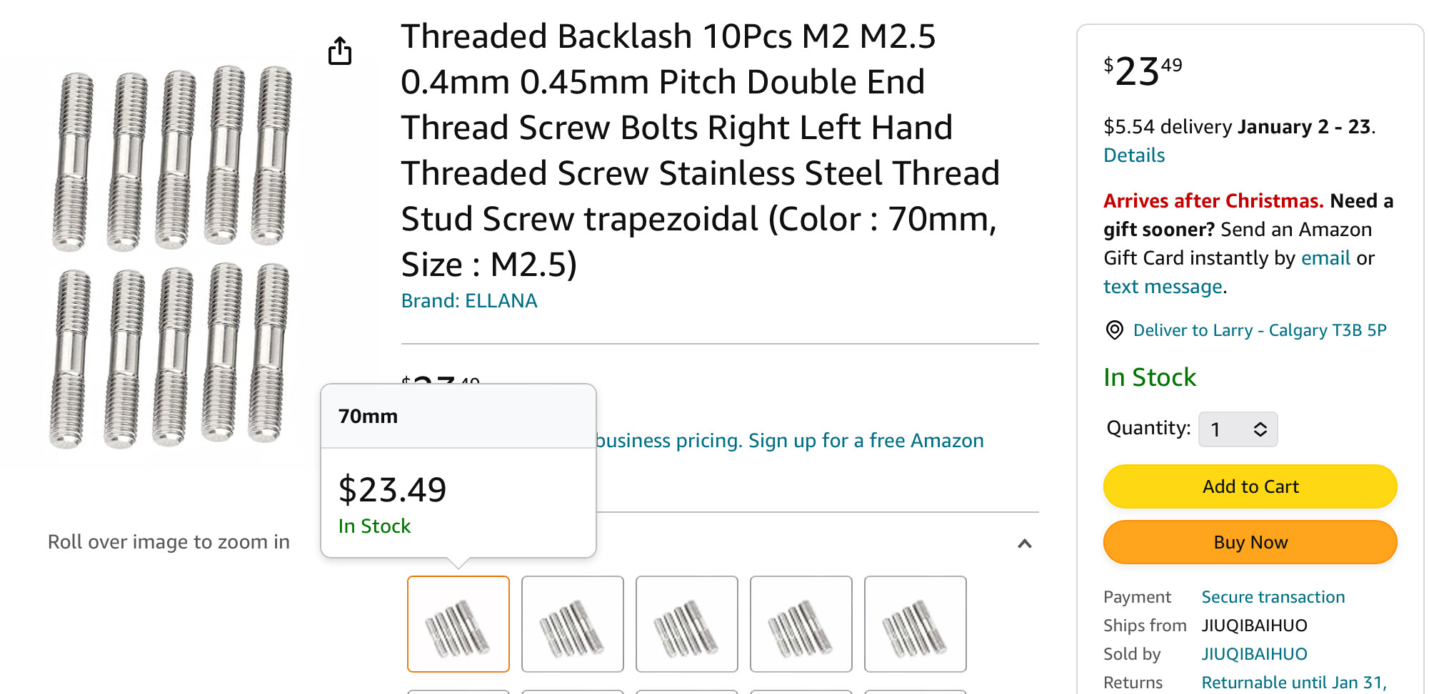

This is as close as I think I’m going to get. :roll_eyes:
For my application, this might work.
Amazon
You might want to look at what trapazoidal threads look like. They will NOT mate to standard metric threads!
