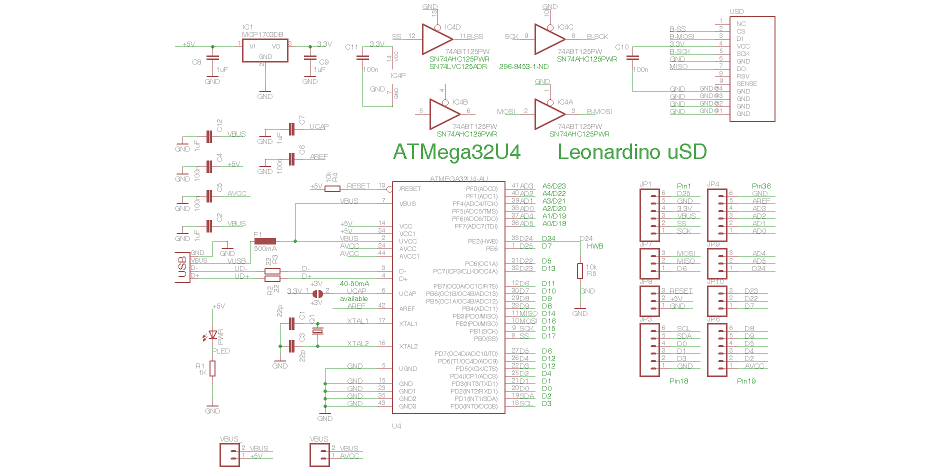

i would like to ask if arduino leonardo has a ptc and overcurrent protection
if any one knows pls tell me where it is on the board and its specifications(or its name and type)
and last is it possible that on that specific board could anything go bad and short out
Leonardo schematic diagram is available online.
F1 (near the USB socket) is a 500mA polyfuse (very slow reacting, and auto resetting).
The fairly large square part with 50... printed on it, near the reset button.
Don't assume it will protect your PC.
Keep the metal-dust away... :slight_smile:

Photos to compare genuine Arduino.
The green thing on the left, it is not a 501k. It is a polyswitch.
