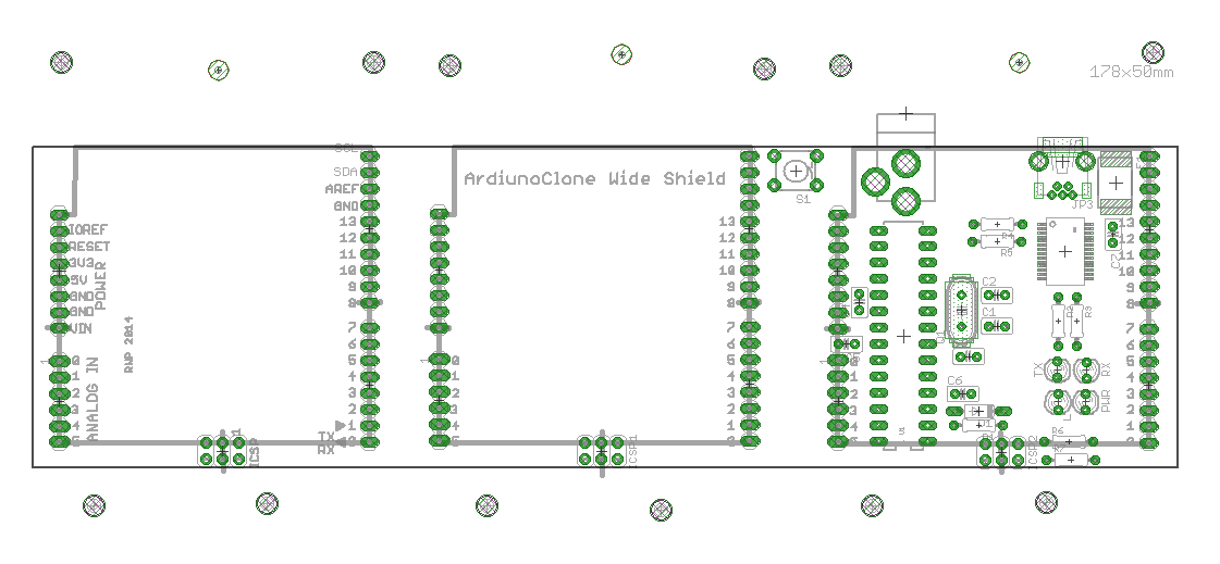

So a card like this - male headers at all locations facing “down” and plugging into female headers on all shields. All cards sit on the same plane.
Would it be too hard to do such a thing where the pins are stepped down a level from the arduino, so that they sit on the same plane? It would be like one of those 'wide' shields, but with female headers on the same level as the arduino for shields to plug into. Would I have to make this myself, or are there companies out there that make custom shields?
So something like this then. 178mm wide, could be a little narrower, 50m tall. Trying to hold to <200mm x 50mm for board size price break. I do custom boards, custom shields. What are you after besides the platform to mount stuff onto?
WideUnoPlan.jpg|960x720
UnoWideShield.png|1121x517
some ideas came up - rotate the three "elements" 90 degrees so all connectors are on the outside? - why mount an Arduino on the middle part, let the middle (or left or right) part BE an Arduino -> allows 3 shields iso 2 - add some grid in the free space so one can add e.g. I2C eeprom's or shift registers - add screw connectors (placeholders for) screwconnectors on the free sides - of course reset button
CrossRoads: So something like this then. 178mm wide, could be a little narrower, 50m tall. Trying to hold to <200mm x 50mm for board size price break. I do custom boards, custom shields. What are you after besides the platform to mount stuff onto?
The pictures you have included seem like that shield would work great.
Rotating - sounds good, would make board really long. I think also less practical for power headers. Maybe just turn the outer ones?.
I could see making one of the three a arduino clone.Or at least alloeing for it to be populated as one.

outer two is also an option. Think you should take 3 shields - with their connectors - and place them side by side, rotate and see how connections are affected. Eg. the ethernetshield has a big connector.
Most important is maybe to include some "slack space" as not all shield are the same size (esp display shields , screw shield) maybe check http://shieldlist.org for the extra space needed to work with 90% of the shields.

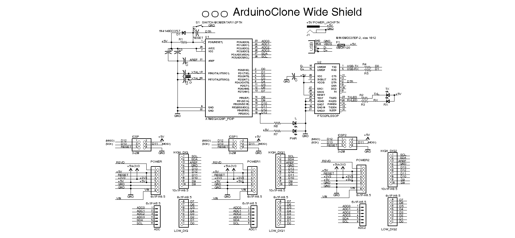

Okay, here’s one variation: Arduino clone that can accept 3 shields.
And its schematic
ArduinoCloneWideShieldSch.png|1735x802

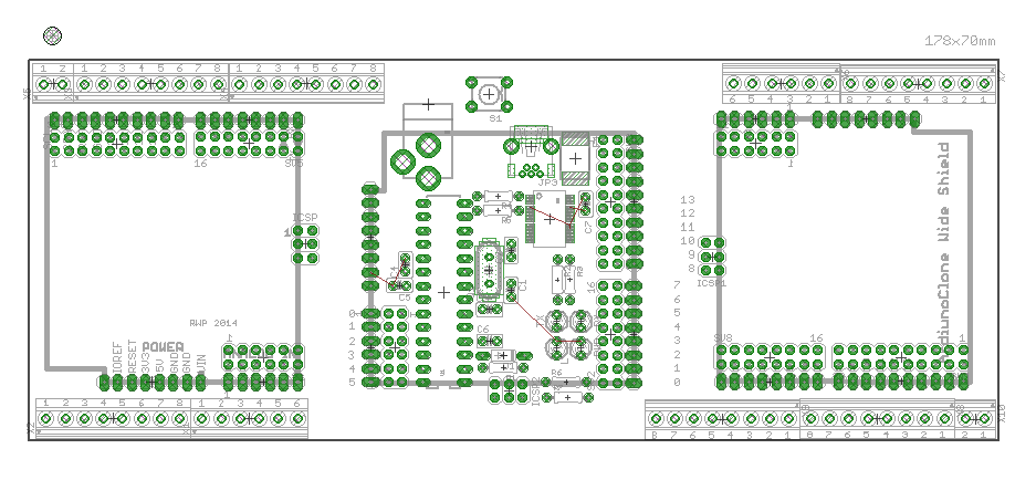

And a dual-screw variant
ArduinoCloneWideScrew.png|1124x520
ArduinoCloneWideScrewSch.png|1487x688

WireJunky, I got to thinking more about your question in #10 - I think you are asking how much trouble to put essentially a jumper space at each pin to let users wire each arduino signal to a slave header? I think that would be really useful, lets users only connect what is needed & avoids signal contention between shields. Take a while to draw up.
So something like this - each header with a jumper pad to connect the header to an arduino signal, either the one adjacent to it, or to a different one. Only +3.3, +5, and Gnd are connected.
ArduinoCloneWideScrewJumpers.png|937x434
CrossRoads: So something like this - each header with a jumper pad to connect the header to an arduino signal, either the one adjacent to it, or to a different one. Only +3.3, +5, and Gnd are connected.
Really flexible this way ! +1
Need to get 8 Grounds connected up still before I could order cards (in February, after the China spring hioliday). You can almost make them out as black lines above.
