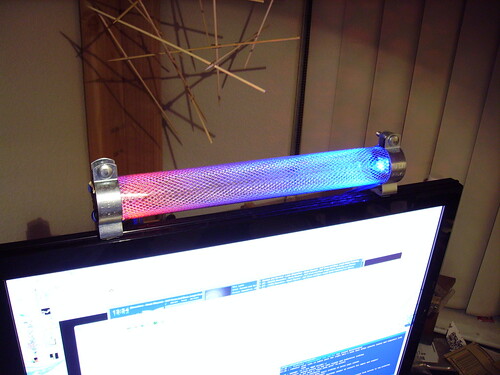

here is a video of one scoop filled with light

I have got to say you are my new favorite person!!! :wink: I have been tweaking and testing for the past 2 hours and i still am trying to make my mind up. I had no idea the color and speed was going to be so simple. Even the Trailing and leading edges. BRILLIANT!!! Had the 2 edges 8 LEDs wide.
I LOVE THIS THING ;D
