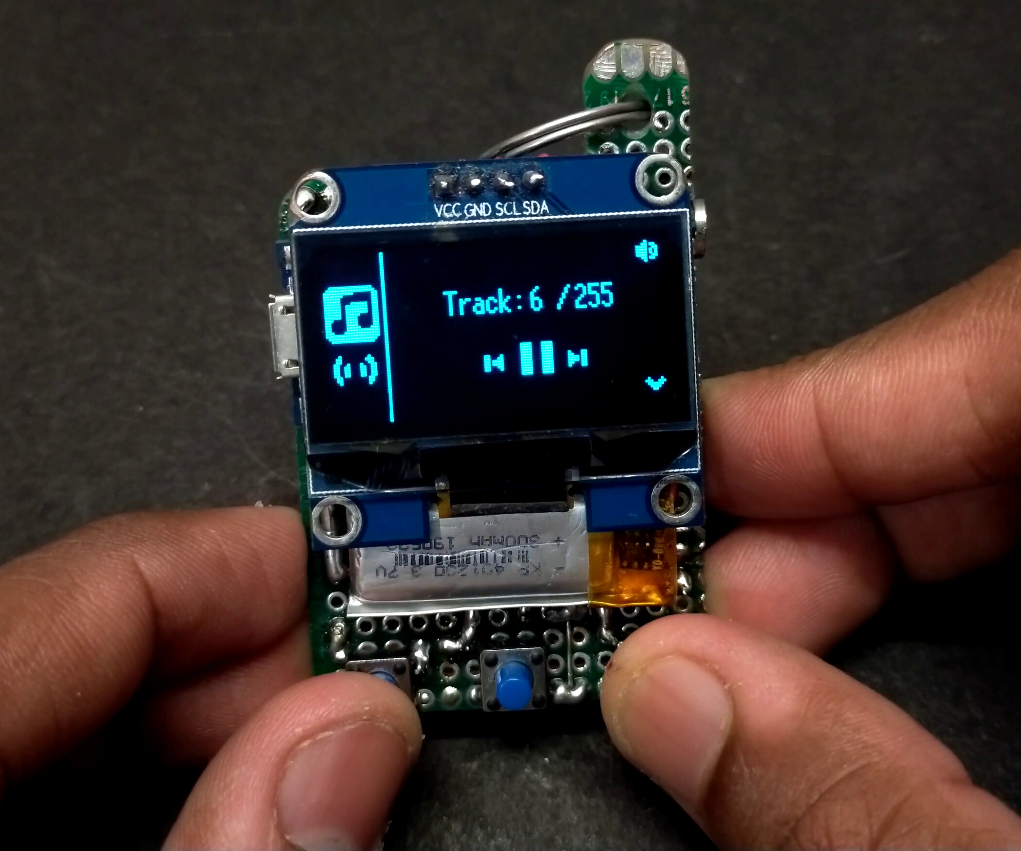

So when I try to assemble a simple MP3 player:
I found that instructables were not always meant to be a step by step guide, especially when step 1 is a doozy.
Got my screen wired up, got my UNO R3 ready and so as the 5th paragraph suggests I decide I should test it to make sure it works.
