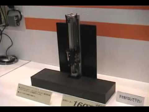

How about a vertical linear motor.
It would probably be unique and quite a talking point for visitors.

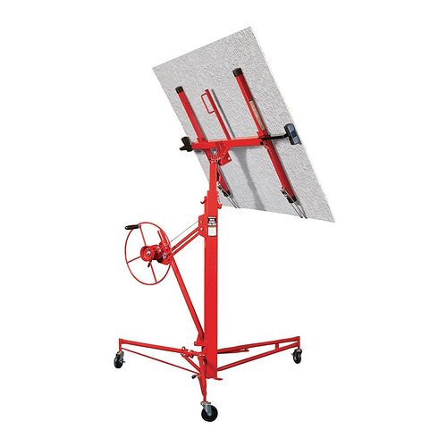

you can buy a car winch for cheap and use that as the basis for the project.

mikb55,
This is absolutely what I need.
But There doesn't seem to be retailers for this tech.
Instead, and in the case i cannot buy a few of them, a linear motor would fit, don't you think?

The commercial units are designed for precision which you don't need, so your budget should be more than enough to purchase some magnets, wood, copper wire (for coils), a power supply, cable harness, hall effect sensors and limit switches. Build a small prototype then upscale.

you will not find retailers, but sales reps.
for 2.5 meter lift, you should not be over $10,000 USD for one motor and the drive package.

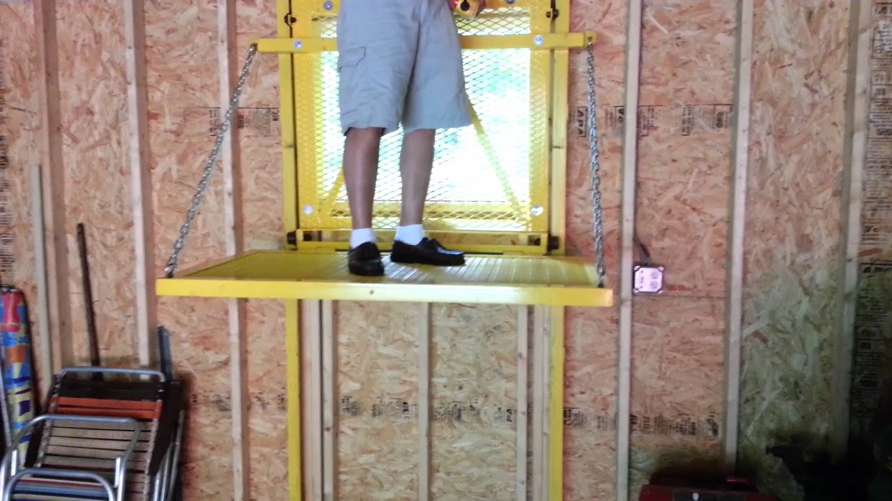

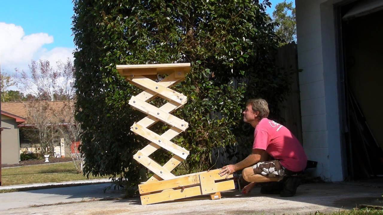

Various lift ideas.
I saw a lift made from garage door parts. Used the track as the guide and the motor/chain for the lift. Should be simple to find parts. Has limit switches build in and safety limits as far as load goes.
