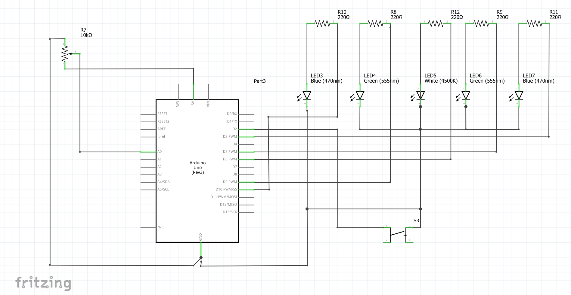

Hi! Can anyone help me with the coding?

My goal is to make the LEDs turn ON once the button is pressed (the LEDs need to stay ON), then the LEDs will turn OFF when I press the button again.
After I turn ON the LEDs for a few seconds, I want to make a light sweeping effect from LED Pin 1 to 5 where I also be able to adjust the LEDs brightness using the potentiometer.
If it's possible, I also want to use the random() command to make a random light sweep effect, but I don't know how to use it.
I attached my circuit too.
Thank you in advance.
 ![image](https://europe1.discourse-cdn.com/arduino/original/4X/7/3/c/73c502e4001bb83dfac16147c387ee7e8dedc379.png)

Welcome to the forums! What is your code doing now or not doing now that you want to change? You describe what you want it to do, but now what it is currently doing.
It appears you have mashed together some code since you have all 5 of your leds as single variables (ledPin1, ledPin2, …) as well as an array of the pins `ledPins[]`. You certainly do not need both.
Your logic appears flawed:
> [@kakoona](#):
> ```arduino
> if (digitalRead(btnPin) == HIGH && btnIsUp) { // if the button is pressed AND the button was UP
> btnIsUp = false; // the button is DOWN now
Since your have your button wired between your input pin and ground (GOOD) and you have declared the in as INPUT\_PULLUP, that means the pin will read HIGH when **NOT** pressed and read LOW when pressed. It is the reverse of what most newbies first think it should be, but a very common situation.
I would suggest getting all those things fixed/sorted out first before you start tackling tougher sequences of lights. Once you do, it will be worth your while to study this: [Demonstration code for several things at the same time - General Guidance - Arduino Forum](https://forum.arduino.cc/index.php?topic=223286.0)
It will help you do the patterns while still checking your button.
Good Luck!

Hi! Thank you for the reply.
Currently, when I use the code, all of the LEDs turn ON at the start before I press the button. Then, when I press the button, the LEDs start doing the LED array 2 times and turn OFF. Then when I press the button again, it turns all the LEDs ON, then repeats the LED array 2 times and turns OFF.
I did test 2 codes to turn and keep the LEDs ON when I press the button, then turn it OFF on the next press.
First Code (works well)

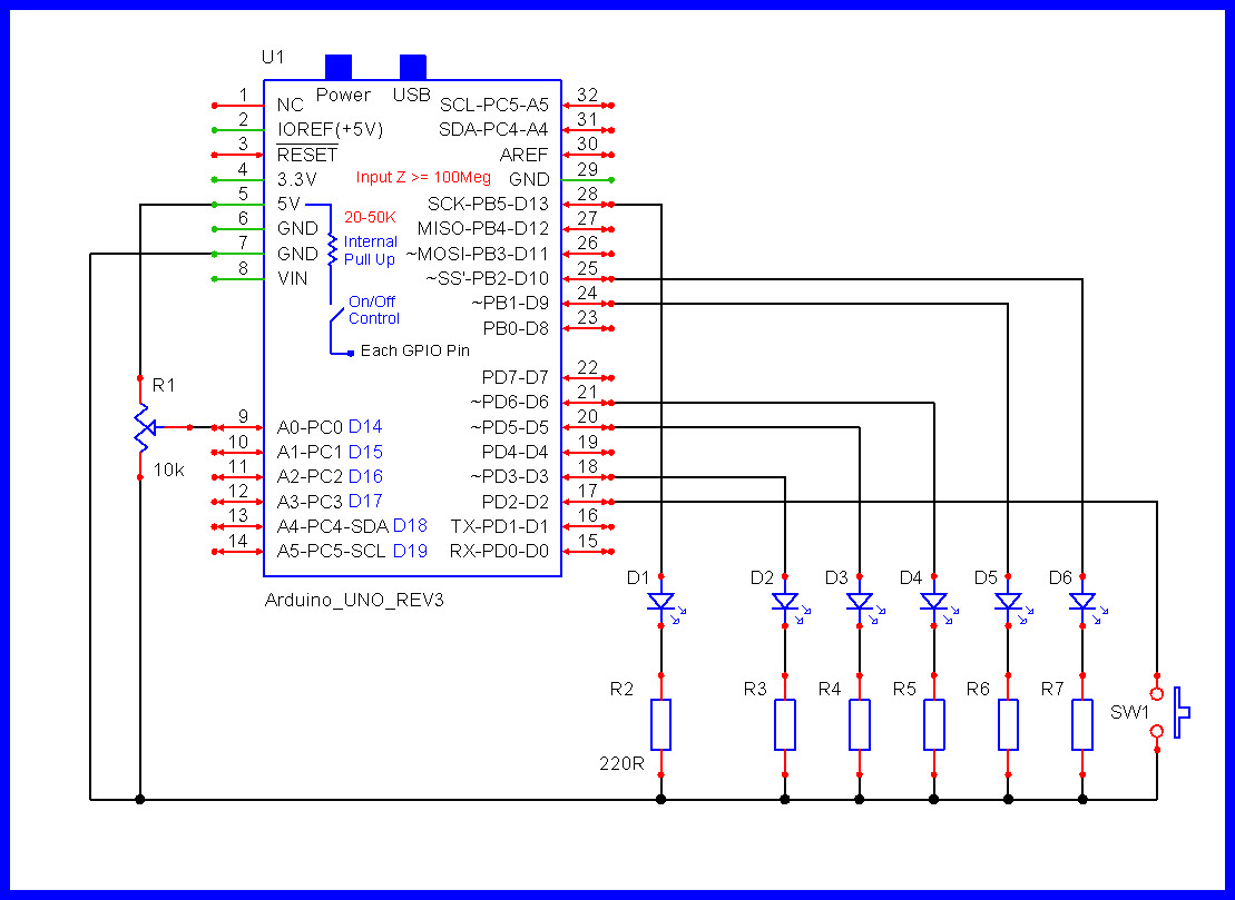

- We always start with writing a preamble which you have done.
- Next we always make a preliminary schematic, see below, does this make sense to you ?
You can use KiCAD or EasyEDA for drawing.

This is the same, right? Although it’s more confusing to look at..
