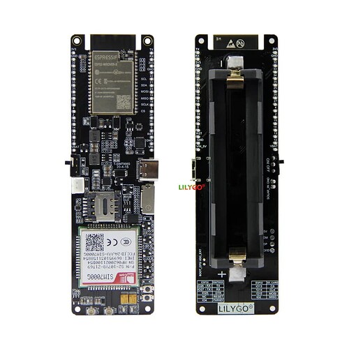

Lilygo Tsim doesn't start on their own?
Hi again, so I wanna know if somebody have encounter this problem, Im using a lilygo tsim7000g (works on a ESP32), and when reading conected to the pc is all good, but when I disconnect and turn on the device alone doesnt make any readings and I dont know why. Then I connect a powerbank to the port that I use with the pc and start doing the readings of gps, so I dont actually know if conecting or giving power in that port actives all, or If I need like active the lilygo to start working (the lilygo has also an adapt to add a battery and is already there) So i think that could be the problem, but I dont really know how to start that

When You "disconnect" where does the power come from?
From a batery in the back, but to really start it i need to conect a powerbank in the USB port, so i don't know if there is a command like to turn on the lilygo on their own
What battery? Connected to what pin?
Please post schematics and stop posting words.
