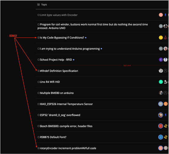

> [@gcjr](#):
> you can append "- Solved" to the title
that's the old way - now we we have a way to mark a post as the solution (a click under the suitable answer) and the thread will be shown with a checkmark in the list of posts
 ![image](https://europe1.discourse-cdn.com/arduino/original/4X/f/6/b/f6bf8d6d3a4098827c4278742f478c5c405f524d.png)

Yes got it, you actually put on an arrow where I just marked as solved, thanks for the hint. Tis subject we are writing into is not solved yet.
