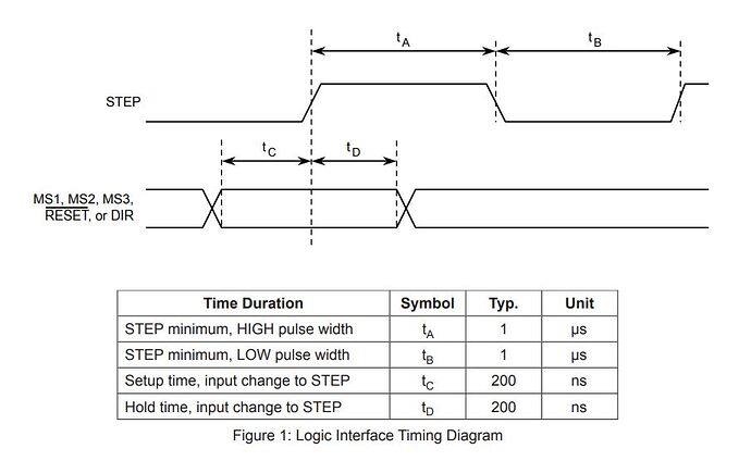

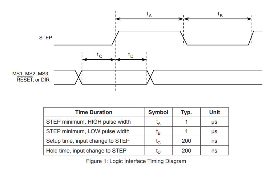

I think a delay time of 1 microsec between step pin low and step pin high (as per the code in #7) is a bit tight, and unnecessarily so. Admittedly, the overheads of digitalWrite() and delayMicroseconds() will add loads, but I can't find a proper spec for the PCB, so heaven knows what delays there may be on that.
@AxeGrinder, make it at least 5 microsec - you've got all day!
This is from the Allegro datasheet for the A4988:
