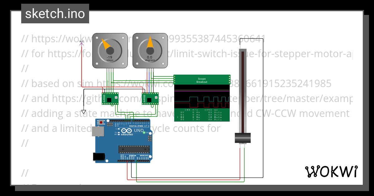

> [@gundamzzpk](#):
> Now I just need to incorporate the part where it hits the limitswitch when return instead of the negative set value there
One of the problems with incorporating a limit switch is planning where to do the checking of the limit switch.
When you have blocking code like:
> [@gundamzzpk](#):
> ```arduino
> void loop() {
> myStepper.setSpeed(speed);
> myStepper.step(-1000);
> myStepper.step(10000);
or:
> [@gundamzzpk](#):
> ```arduino
> while (motor.run());
the program blocks other things from happening until the move is complete, so it can move past the limit switch before it gets a chance to read the switch.
The non-blocking code as in the AccelStepper Bounce Example, runs all the way through loop 1000s of times per second, allowing lots of opportunity to read the limit switch and act/re-target appropriately or do several other things at apparently the same time.
Looking at the code you have in #15, I wonder what you would want to have happen after the cycleCount cycles, or what might initiate a second set (or the first set) of cycles.
If I were doing it with a state machine as in my #13 untested snippet above, I'd add a third state, IDLE, for when the device isn't supposed to be moving. And then each time I completed a cycle, I'd increase your '`currentCycle`' variable and decide whether to do another cycle or switch to IDLE.
It would be something like the slightly more tested code in this simulation:
> **[BounceNStateMachine - Wokwi ESP32, STM32, Arduino Simulator](https://wokwi.com/projects/399355387445360641)**
> Run IoT and embedded projects in your browser: ESP32, STM32, Arduino, Pi Pico, and more. No installation required!
```arduino
// https://wokwi.com/projects/399355387445360641
// for https://forum.arduino.cc/t/limit-switch-issue-for-stepper-motor-application/1265784/12
// based on sim https://wokwi.com/projects/388661915235241985
// and https://github.com/waspinator/AccelStepper/tree/master/examples/Bounce
// adding a state machine to have an un-balanced CW-CCW movement
// and a limited number of cycle counts for
// Bounce.pde
// -*- mode: C++ -*-
// Make a single stepper bounce from one limit to another
// Copyright (C) 2012 Mike McCauley
// $Id: Random.pde,v 1.1 2011/01/05 01:51:01 mikem Exp mikem $
#include <AccelStepper.h>
// Define a stepper and the pins it will use
AccelStepper stepper(1, 10, 7); // Defaults to AccelStepper::FULL4WIRE (4 pins) on 2, 3, 4, 5
int stateSwitch = 0;
long positionAbs = 200;
long bigPos = 1000;
int cycleCount = 2;
int currentCycle = 0;
const byte limitSwitchPin = A1;
  pinMode(limitSwitchPin, INPUT_PULLUP);
  // Change these to suit your stepper if you want
  stepper.setMaxSpeed(100);
  stepper.setAcceleration(100);
  stepper.moveTo(-500);
  bool limitSwitchActive = digitalRead(limitSwitchPin)==LOW || stepper.currentPosition() < -100;
  // If at the end of travel go to the other end
  switch (stateSwitch) {
    case 0: // moving CCW
      if (stepper.distanceToGo() == 0 // finished motion?
          || limitSwitchActive // active limit switch
        currentCycle += 1;
        if (currentCycle <= cycleCount) {
          stepper.moveTo(bigPos - positionAbs);
          stateSwitch = 1; // move CW
          stateSwitch = 2; // go idle
    case 1: // moving CW
      if (stepper.distanceToGo() == 0) {
        stepper.moveTo(-positionAbs);
        stateSwitch = 0;
    case 2: // IDLE
      ; // do nothing
  stepper.run(); // move stepper as needed
(A more professional SM would use an `enum States {CCW,CW,IDLE} stateSwitch = CCW;` to make the code cleaner and more self-documenting.)
One could check a button within the IDLE state in order to reset the currentCount and restart.

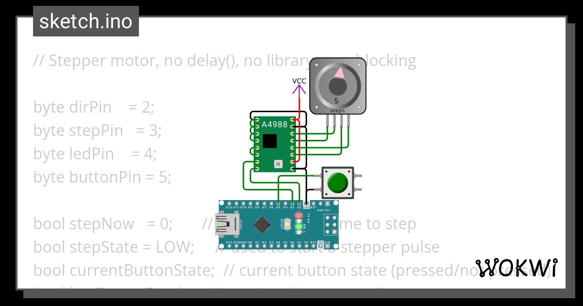

@gundamzzpk - Here is a simulation for a single A4988 stepper motor driver. It might not work on your live system. It uses a square wave (50% duty cycle) with the option of single pulse. It does not use a library. It is non-blocking. Press the "limit switch" to change motor direction.
> **[stepperNonBlocking - Wokwi ESP32, STM32, Arduino Simulator](https://wokwi.com/projects/366398086217405441)**
Files for [WOKWI.COM](http://WOKWI.COM)
> **sketch.ino**
> ```arduino
> // Stepper motor, no delay(), no library, non-blocking
> byte dirPin = 2;
> byte stepPin = 3;
> byte ledPin = 4;
> byte buttonPin = 5;
> bool stepNow = 0; // flag to indicate time to step
> bool stepState = LOW; // used to start a stepper pulse
> bool currentButtonState; // current button state (pressed/not pressed)
> bool lastButtonRead; // previous button reading
> unsigned long previousMillis = 0; // store last step
> unsigned long interval = 2; // (milliseconds) half-interval for stepping
> unsigned long debounceTimeout = 50; // debounceTimeout
> unsigned long timer = 0; // measures button press time
> void setup() {
> Serial.begin(9600);
> pinMode(dirPin, OUTPUT);
> pinMode(stepPin, OUTPUT);
> pinMode(ledPin, OUTPUT);
> pinMode(buttonPin, INPUT_PULLUP);
> digitalWrite(dirPin, HIGH); // 1 = CW
> welcome();
> void loop() {
> checkElapsedTime();
> stepMotor();
> readSwitch();
> void readSwitch() {
> bool currentButtonRead = digitalRead(buttonPin); // read button pin
> if (currentButtonRead != lastButtonRead) { // if button pin reading changes...
> timer = millis(); // ...start a timer
> lastButtonRead = currentButtonRead; // ... and store current state
> if ((millis() - timer) > debounceTimeout) { // if button read change was longer than debounceTimeout
> if (currentButtonState == HIGH && lastButtonRead == LOW) { // ... and State NOT pressed while Button PRESSED
> // change stepper direction and light the LED
> digitalWrite(dirPin, !digitalRead(dirPin));
> digitalWrite(LED_BUILTIN, !digitalRead(LED_BUILTIN));
> currentButtonState = currentButtonRead; // change the state
> void checkElapsedTime() { // for the stepper motor
> unsigned long currentMillis = millis(); // store the time
> if (currentMillis - previousMillis >= interval) { // compare elapsed time to interval
> previousMillis = currentMillis; // store last step time
> stepNow = 1; // flag to indicate it is time to step the motor
> void stepMotor() {
> if (stepNow) {
> stepNow = 0; // clear step flag
> // two methods to step the stepper...
> squarewave(); // HIGH for interval, LOW for interval
> // singlepulse(); // HIGH/LOW pulse then wait for next interval
> void squarewave() { // toggle the state
> stepState = !stepState;
> delay(10); // let the motor catch arrive at the next step
> digitalWrite(stepPin, stepState); // step the motor
> void singlepulse() { // minimum requirement to step a stepper
> digitalWrite(stepPin, HIGH);
> delay(10); // let the motor arrive at the next step
> digitalWrite(stepPin, LOW);
> void welcome() {
> Serial.println("Step and change direction using event timing, non-blocking, no library, square wave or single pulse.");
> **diagram.json**
> ```arduino
> "version": 1,
> "author": "Anonymous maker",
> "editor": "wokwi",
> "parts": [
> { "type": "wokwi-arduino-nano", "id": "nano", "top": -33.6, "left": -38.9, "attrs": {} },
> "type": "wokwi-stepper-motor",
> "id": "stepper1",
> "top": -230.41,
> "left": 89.82,
> "attrs": { "size": "8", "arrow": "pink" }
> { "type": "wokwi-a4988", "id": "drv1", "top": -148.8, "left": 14.4, "attrs": {} },
> { "type": "wokwi-vcc", "id": "vcc1", "top": -200.84, "left": 67.2, "attrs": {} },
> "type": "wokwi-pushbutton",
> "id": "btn1",
> "top": -80.2,
> "left": 96,
> "attrs": { "color": "green" }
> "connections": [
> ["drv1:GND.2", "drv1:GND.1", "black", ["h19.35", "v57.6"] ],
> ["nano:GND.2", "drv1:GND.1", "black", ["v0"] ],
> ["drv1:STEP", "nano:3", "green", ["h-19.2", "v38.4", "h67.2"] ],
> ["drv1:RESET", "drv1:SLEEP", "green", ["h-9.6", "v9.6"] ],
> ["drv1:GND.2", "drv1:ENABLE", "black", ["h19.35", "v-20.85", "h-76.8", "v11.33"] ],
> ["nano:2", "drv1:DIR", "green", ["v-28.8", "h-67.2", "v-19.2"] ],
> ["vcc1:VCC", "drv1:VMOT", "red", ["v0"] ],
> ["drv1:VMOT", "drv1:VDD", "red", ["h9.75", "v57.6"] ],
> ["drv1:2B", "stepper1:A+", "green", ["h0"] ],
> ["drv1:2A", "stepper1:A-", "green", ["h0"] ],
> ["drv1:1A", "stepper1:B-", "green", ["h0"] ],
> ["drv1:1B", "stepper1:B+", "green", ["h0"] ],
> ["drv1:ENABLE", "drv1:MS1", "green", ["h-9.6", "v9.6"] ],
> ["drv1:MS1", "drv1:MS2", "green", ["h-9.6", "v9.6"] ],
> ["drv1:MS2", "drv1:MS3", "green", ["h-9.6", "v9.6"] ],
> ["nano:GND.2", "btn1:2.l", "black", ["v0"] ],
> ["nano:5", "btn1:1.l", "green", ["v0"] ]
> "dependencies": {}
