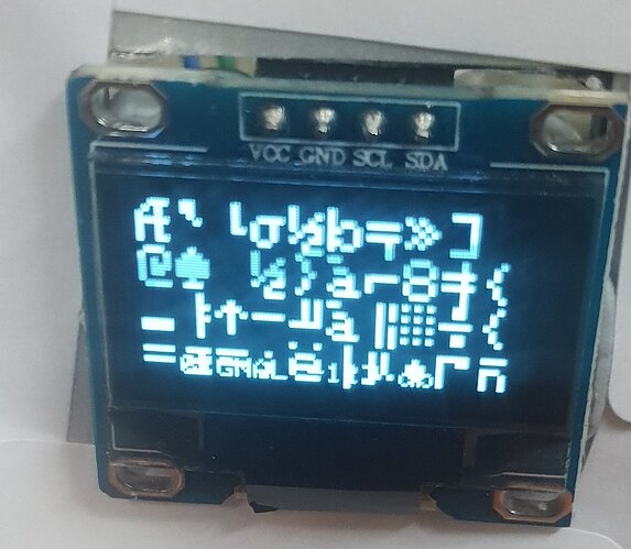

Hi I am very new to programming but getting the hang of it , 12 moths ago i could barely get an arduino to even turn on
today i have setup up a lora on promini and it will send some text to my receiver also a promini
the receiver has a oled and an alarm fitted to it so when the signal comes from the TX it will display on screen the message and it will set off an alarm , i am doing all of this with example code , melded into my plan to use it , it all works fine , BUT , when there is no signal for a while the oled starts to accumulate random characters on the screen and will eventually fill the screen , when a signal comes through from my transmitter the screen returns to normal and displays the current message .
Also with some of the unwanted signals will sound the alarm . this is definitely not wanted.
So I want to capture some info from my transmissions by the receiver and compare it to a known number or code and the receiver can then reject the unwanted signals .
Can someone give me a hint on how to capture and the code eg 123 from my tx .
I can tell you the code comes through as individual letters and numbers with a comma inbetween and to read it i have to use char(lora.read) etc, what i am doing now is capturing the lora.read as an int
and then serial.print ((char) message) and this prints to the oled 1 character at a time .
So i am thinking i should be able to capture part of the message that is constant and compare it a saved ,message on the receiver. however i have been unable find how to do this in all of my searches .can someone point me in the right direction please . and thanks .

just pics of what i am getting

Hi Tom,
the receiver is set to 923mhz but it has a wide range because of spread spectrum there is no mechanism to limit what it receives so like any radio it is open to interference
i have a spectrum analyser and if i set it to 25 mhz above and below there are signals all around the core frequency and sometime even on it and occasionally they are long enough to activate the the beeper .
so yes it gets through the levels are usually less then -110db but lora receivers are usually capable of -130db
i am thinking i should be able to capture the first 3 characters and use them to filter out unwanted signals
so my "capt" int does that but i just dont quite get how to get the first 3 chars and use them in a if statement
eg if (first three digits = saved code on Receiver ){ then do this }
else {}
ill also include oled screen jpg

You dont say which library you are using (its helpful to say) but if you think 'interference' is the problem then you would reduce the chances of 'interference' causing false packets to be received by a factor of 65536 if you enabled CRC on packets.
Your code is good for a new-user, but I suspect you can find better ways to handle the data.
Make a more complex message than a single character - which includes the ‘sender address’, and possibly a check value.
Only decode those messages from senders you know.
The RadioHead libraries fully support ReliableDatagram messages which may be better suited to a security application.
hi i think i have a fix
by modifying this part of sketch
int packetSize = LoRa.parsePacket();
if (packetSize) {
to
if (packetSize >=27) {
this measures the size of packet my minimum packetsize is 27 with my full transmitter code
so i have done this and am now waiting for a fail , heres hoping
Well definitely better but still the bit of interference getting through. So limiting the size of the packet helped,
I have looked at crc and datagram , but i dont understand them at this stage . I dont want to make handshake between receiver and transmitter. So that is why i am looking at the packets themselves .
