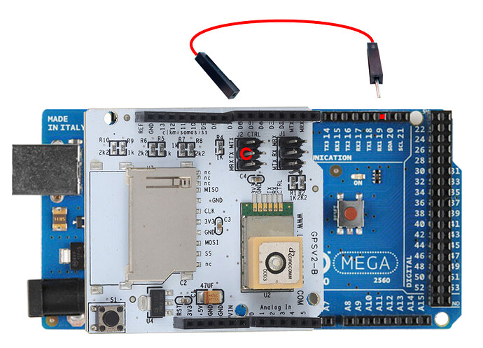

Are you stacking it like a shield, or are you running wires between the Arduino and the Linksprite?
I see the V2B can jumper the GPS TX to any of { D0, D1, D2}, and the GPS RX to any of { D0, D1, D3 }.
This allows you to use Serial for the GPS device, but that would prevent using it for debug/info messages to the PC.
The example program is using SoftwareSerial on pins 2 (RX) and 3 (TX). For the UNO, this means you should jumper the GPS TX to D2 and the GPS RX to D3, as shown on their wiki.
Unfortunately, the Mega does not support SoftwareSerial on pins 2 and 3. Instead, you will have to choose a pair of pins from the list here, and connect them with a wire on the shield, instead of using the jumper block.

Yes it was beginning to dawn on me that stacking it on the Mega wasn't going to work. Time to dig out a breadboard. Thanks for your help.
You can still stack them. You just can't use those jumper blocks.
Cheers,
/dev
Ok, so pardon my ignorance here but how would I jump from the GPS board to presumably Pins 19,18 for Serial 1 on the mega.
Would I have to link pins 2,3 on the GPS to 19,18 on the Mega or is there a better way?
I'll remember the code tags next time!
Use 2 male-to-female "Dupont" wires to go from the Linksprite RX & TX pins, to the Arduino 18 & 19 sockets:
